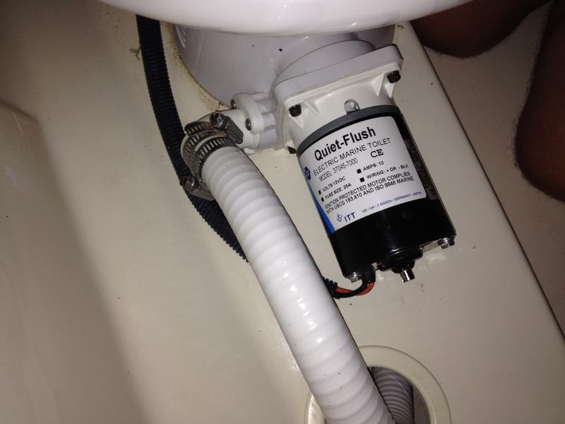

Thanks Peggy. The loop is an interesting idea and potentially the most workable alternative. Easy to do because it's 1-in discharge line at the toilet and I'll be using Trident 102 rubber sanitation hose that seems to be fairly flexible. But the 90 deg discharge port at the macerator slows the discharge down as well I would guess. The photo shows the bowl withe the macerator mounted on the left side. At least the 90 elbow can be rotated in any direction. Jabsco also makes another discharge port that has about a 20 deg bend, but can't be rotated and would flow straight back in the photo. That might be okay to get less restriction and more velocity thru the joker valve if I put the new loop in the line. The loop would also prevent backflow into the bowl I think.
The head is on the port side and the custom-fit tank is in the starboard transom locker (see figure). Not sure why Hunter chose to place the tank farther away...some sort of construction trade off that I don't understand.
