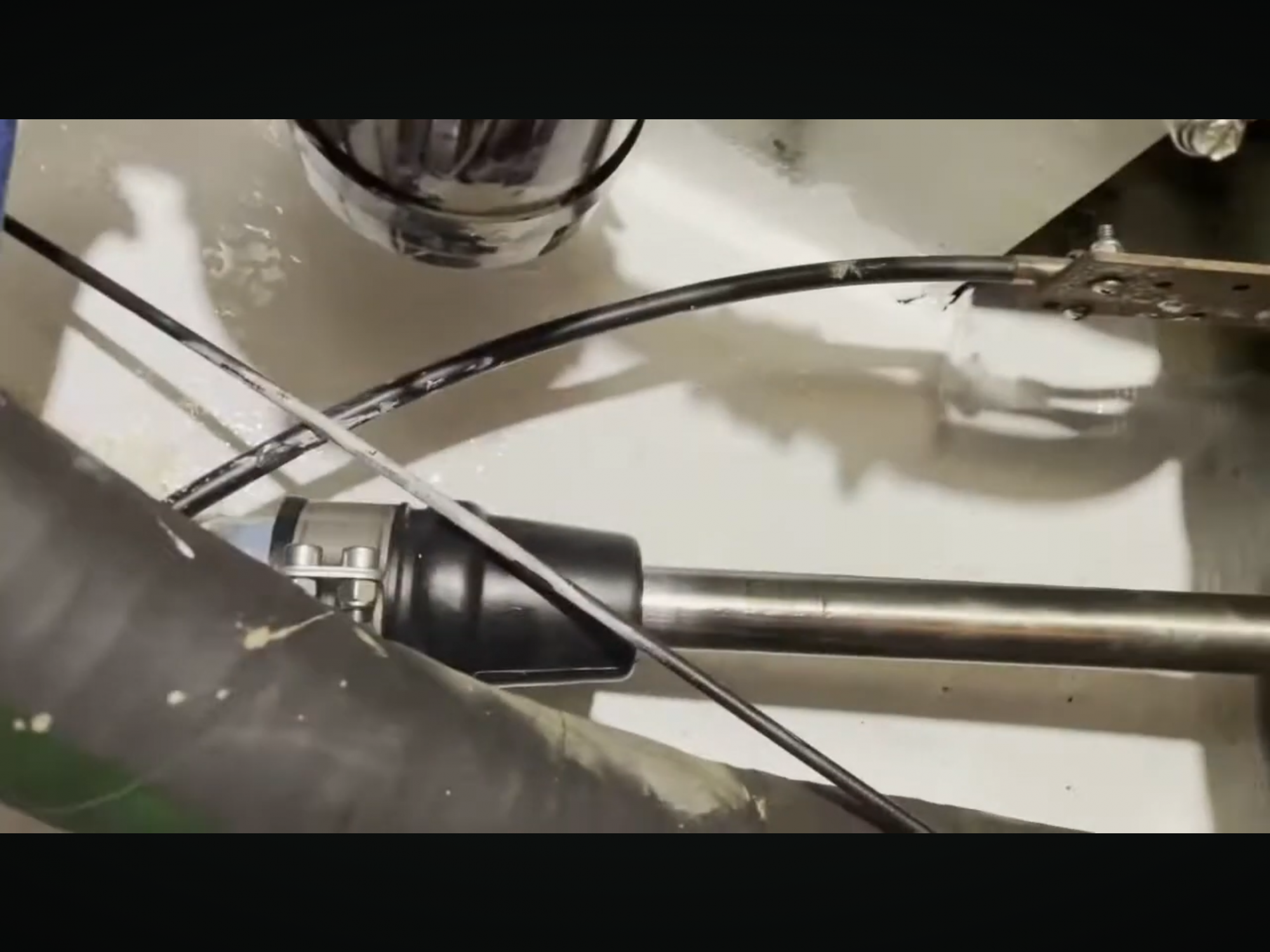

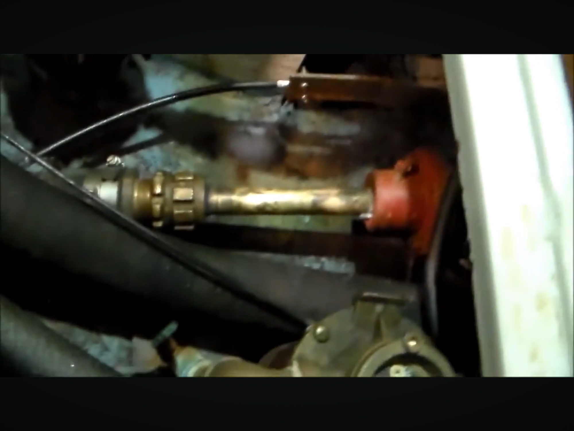

My engine bilge was terrible…dirty and dark. The original blue O’Da bilge paint was flaking off all over the place,
I scrubbed it with several cleaning solutions, even sanding it down in some really rough areas.
Then I painted it with a couple of coats of Bilge Kote (or something like that).
It made a huge difference in brightness and keeping the bilge clean. Still holding up pretty well.
Before…
After…
To be fair, I also replaced the shaft, and upgraded the shaft seal to a Volva Penta dripless, which also helps and opened up some space in the bilge.

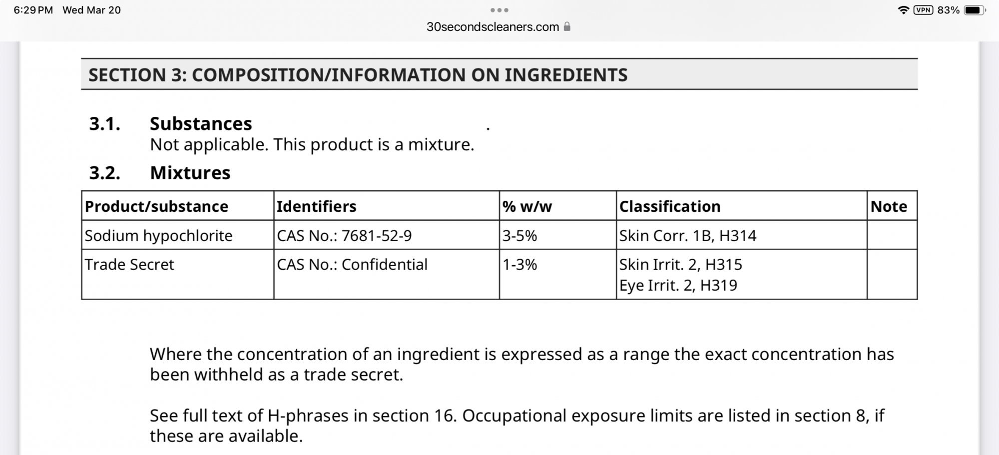

The label identified sodium-hypochlorite as a primary cleanser in the product.
Sodium hypochlorite is an alkaline inorganic chemical compound with the formula NaOCl(also written as NaClO). It is commonly known in a dilute aqueous solution as bleach or chlorine bleach.

13,088
Another popular cleaner is ammonia.
Mixing bleach and ammonia causes the release of toxic vapors called chloramines (these are a group of related compounds that are known to irritate the respiratory system). Exposure to these gases can trigger symptoms like watery eyes, nausea, coughing, shortness of breath, chest pain and irritation to the throat, nose, and eyes.
Be careful with you use of cleaning products.
Yes it is essentially bleach and a surfactant. I've tried dilute bleach alone and it did not work as well. I am working on the assumption that the surfactant is critical in the observed results.
Maybe some dilute bleach and a drop of Dawn dish soap would make a nice homemade alternative

24,926
The label did reference a “Trade Secret” substance.
