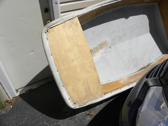

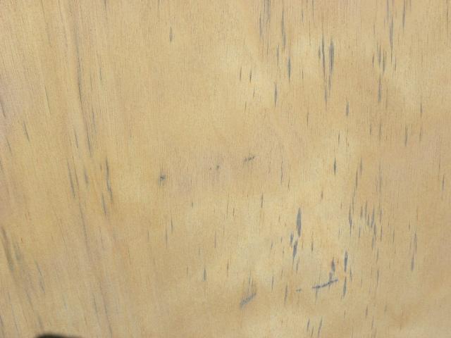

Here are some pics. These are pre Oxalic Acid. I did try it but it didn't remove them. It lightened the wood and faded the streaks. Maybe its time to paint it.
The repair in progress on the floor is due to the dink being blown over this winter in one of the wind storms we had. I had it standing up leaning on the garage to keep critters from taking up residence inside.
