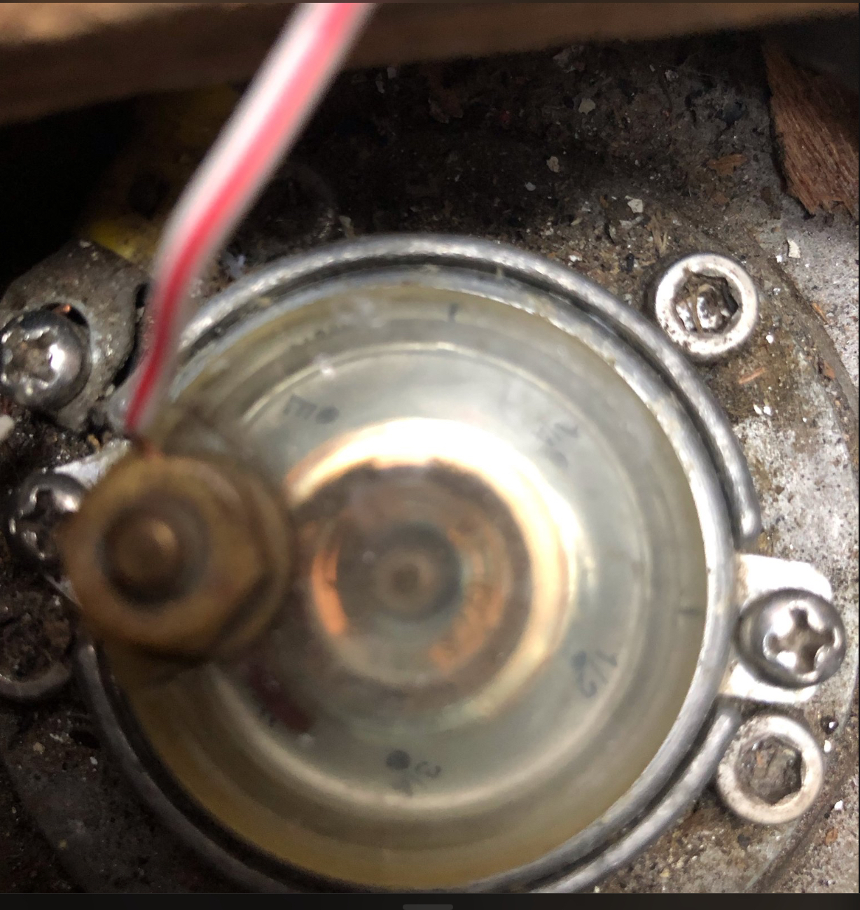

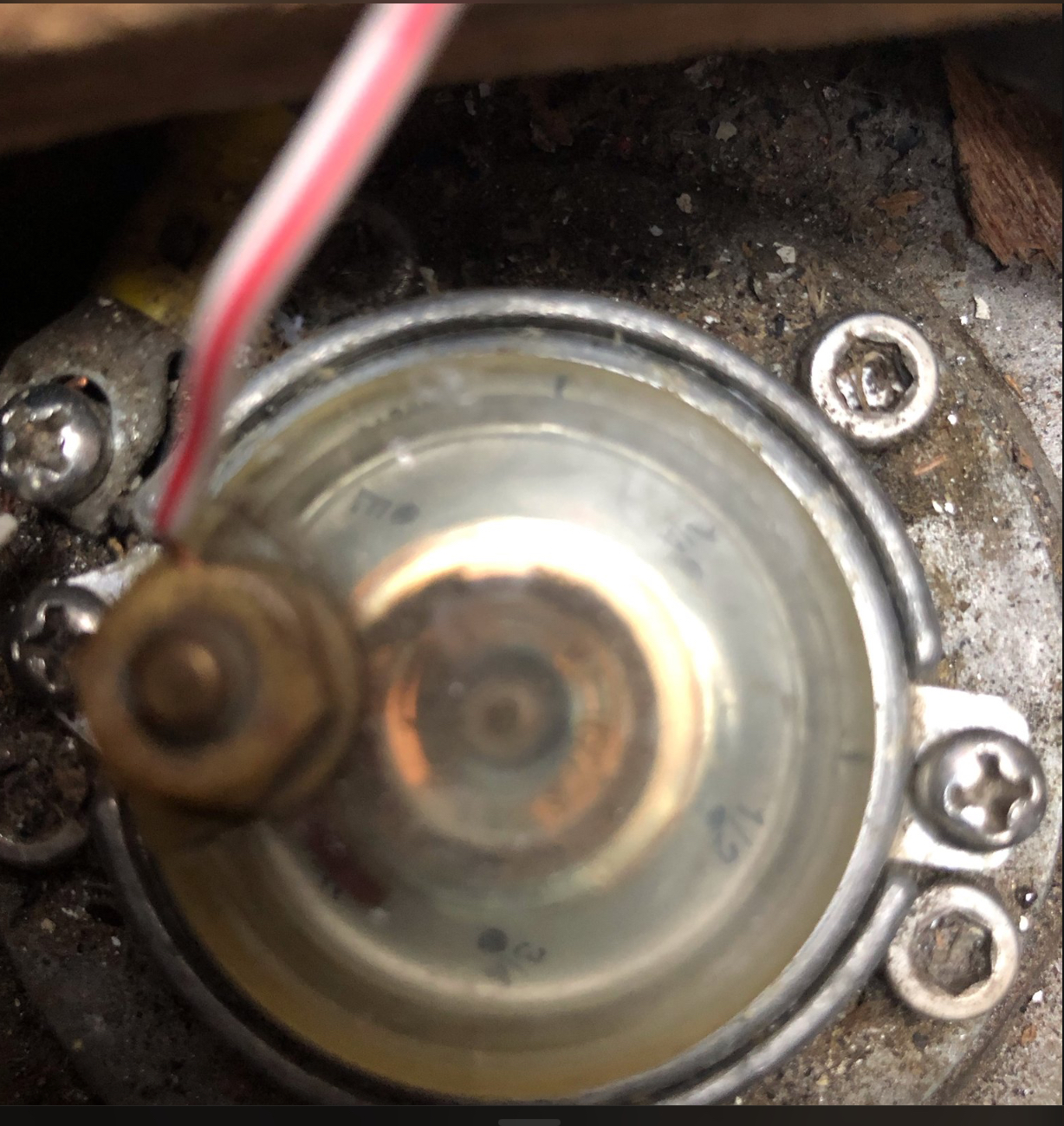

But check the top of your tank and look for some sort of visual gauge…like this:
It may not have a wire connected. This is a actually a mechanical fuel gage and there is a little visual gauge under that dirt.

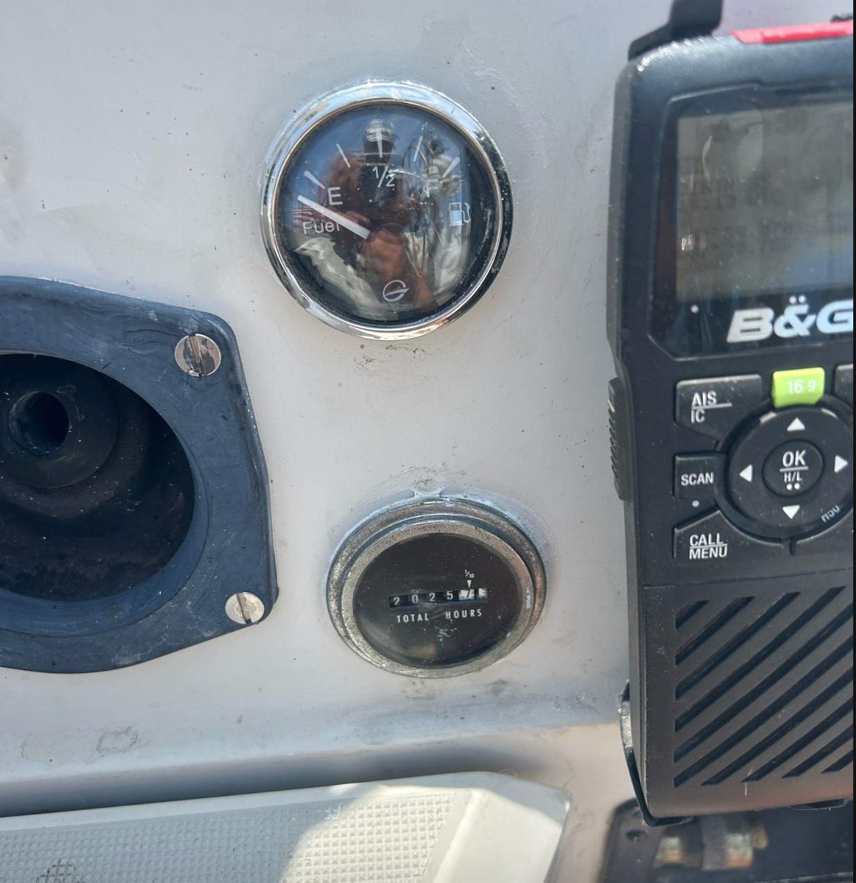

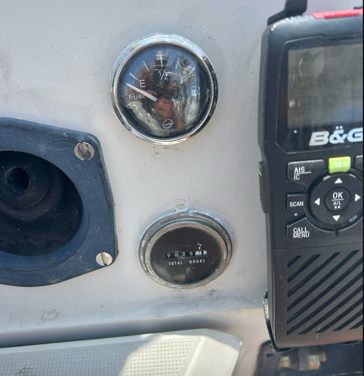

But more importantly, I learned that this gage will drive an electric fuel gauge…which I installed at my helm.
But if you can’t find a gauge, put 5 gallons of diesel in the tank (or fill it) and start keeping track of how many hours you use the engine.
