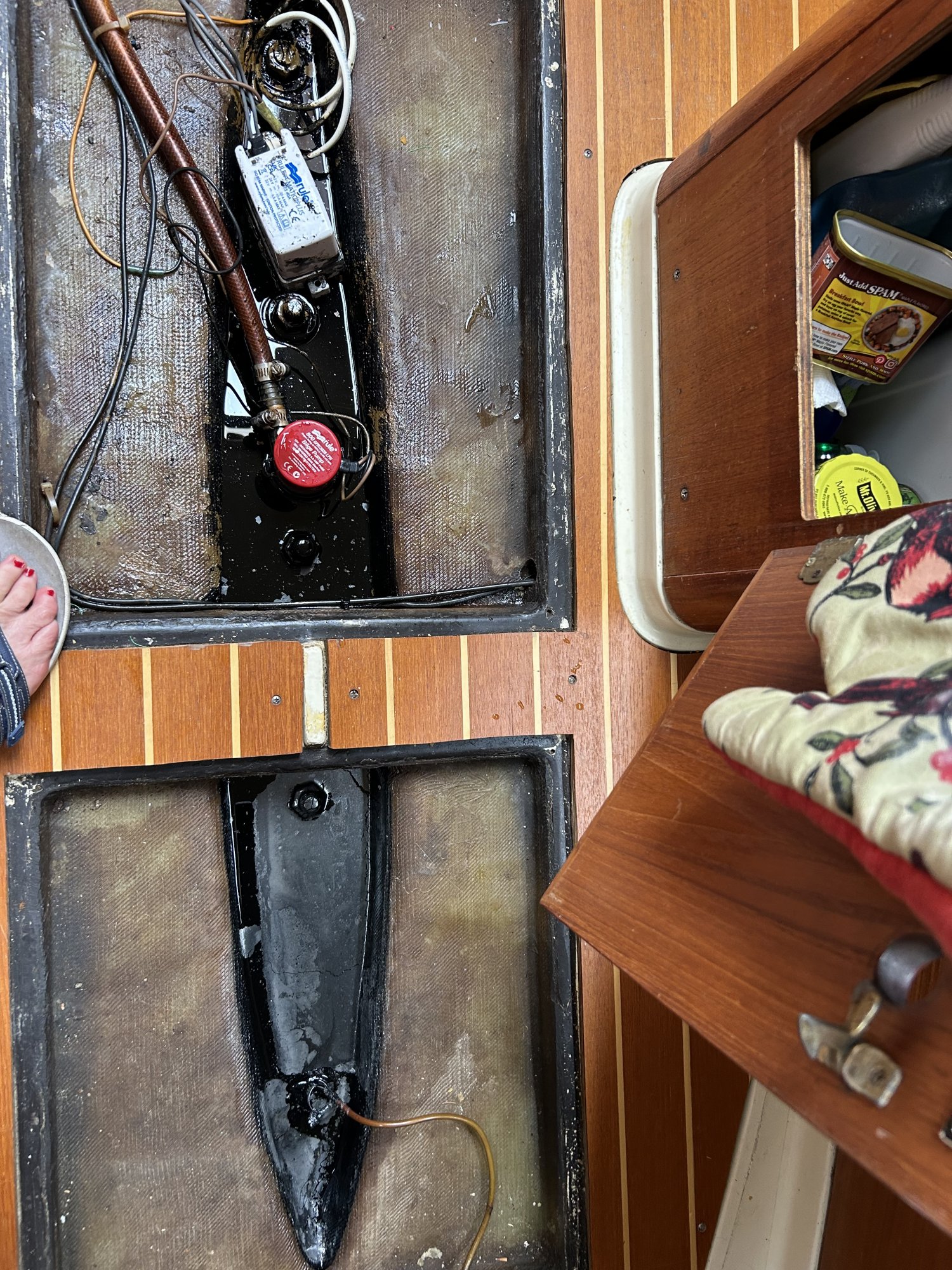

My 1986 Pearson is getting black, rank smelling water in bilge. Seems to be isolated in forward bilge.
She was hauled Fall 2025 after yard winterized (changed engine &transmission oil, ran banfrost through). Rank smelling water first appeared when I checked her out and put on Winter Cover on Christmas eve, and there were black flakes in bilge water then. Now it’s rank smelling and black opaque. Mast was hauled 2023, stepped cabin top with SS support to keel.
I have Yanmar 2GM20F, overhauled in 2017, including Upper Elbow, Exhaust.
Can anyone give me any ideas where to start?
Thank you. Nan
