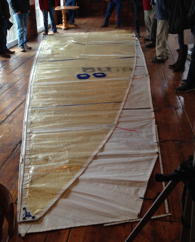

BlueJ gets a new carbon main... 225 sqr feet worth. The current sail is still in very good shape/condition but a one-time offer from my sailmaker makes this too good to pass up. Always fun working with a ACTUAL sailmaker, and not an order taker. We talk back and forth on design issues. I get drawings, he gets feedback. Translates to speed. A HUGE shout-out to Martin at Somerset Sails - keeps us on the podium!
All cut and sewn today; final fitting-out underway.
If you work with a REAL sailmaker, give them a shout-out!

OK a discussion point!
I was talking to the sailmaker about the head of the sail. He has been putting more and more single eyes at the top, foregoing the traditional headboard. This seemed crazy to me, as I figured the headboard had three purposes.
1) Wider head means more sail area
2) Better support of the luff
3) Spread the load over more cloth
His point (true!) is the extra area is actually very small, and that the pressed eye is VERY strong. And the layers of laminated cloth under it will more than hold the load.
Thoughts?

Not as rare as you might think...
Also, remember that boats take a HUGE penalty for sail area above MAX rated/measured area. For most rating systems, there are girth measure points at 1/4, 1/2, 3/4 and 7/8th mainsail luff. The so-called IMS-MAX or PHRF-MAX size. So with a headboard, the extra area would be a sliver triangle with a headboard base of maybe 2-3 inches, going to a point at the 7/8 measure point. I figure its less than a square foot for my sail.
Squareheads are great of course (pogo!) but suffer a huge ratings hit.

Jackdaw - if you are going with the typical plastic mastslides
I do not disagree nor agree, but this is because I mainly look at the cruisers and somewhat less into pure racers. The ones I have seen or look at online or in magazines seem to have (in majority) rather large heads.
I do get the measurements of the main, even the ProSail used by your sailmaker does require MGU, MGM and MGL dimensions to build a sail model (also head and the foot of course). I am not that familiar with the PHRF measurements, but that is simply because I do not race competitively.
Attached photo shows nicely the difference between traditional main and one with really square head, to those that are not very familiar with the topic.
Overall, the new mainsail which is the topic of this discussion is looking very well. Will it have difference draft build in, compared to your previous main?

No we have a Tide Marine track system.
The new sail is the exact same measurements as the old, and looks a lot like the top one in your picture, which looks PHRF-MAX. And it will have the standard 4 inch headboard. If the sail would have been built with just an eye, I would have lost a sliver of sail area, a line that split the headboard to the top telltail.
PS I think the lower sail just has a eye! Makes sense, no need at all for a board.

So even if the benefits are negligible, is there any downside of having the traditional headboard? Off the top of my head (pun not intended) I'm guessing weight aloft may be one. Or is it extra labor?
Nov 8, 2010
11,386
No downside AFAICT. All of my sailmakers comments seems to revolve around it being extra work for them (=cost for me) with limited benefit. But I like them. And I'm writing the check. So head board it is.
Plus, in my mind I LOVE the idea of getting totally max area out of my sailplan. Our races are often determined by just a few seconds. I want all the help I can get from my sails!
If I ever LOST a race by a second (closest margin has been 4) with a headboard-less mainsail, I KNOW what I would blame! ;^)
