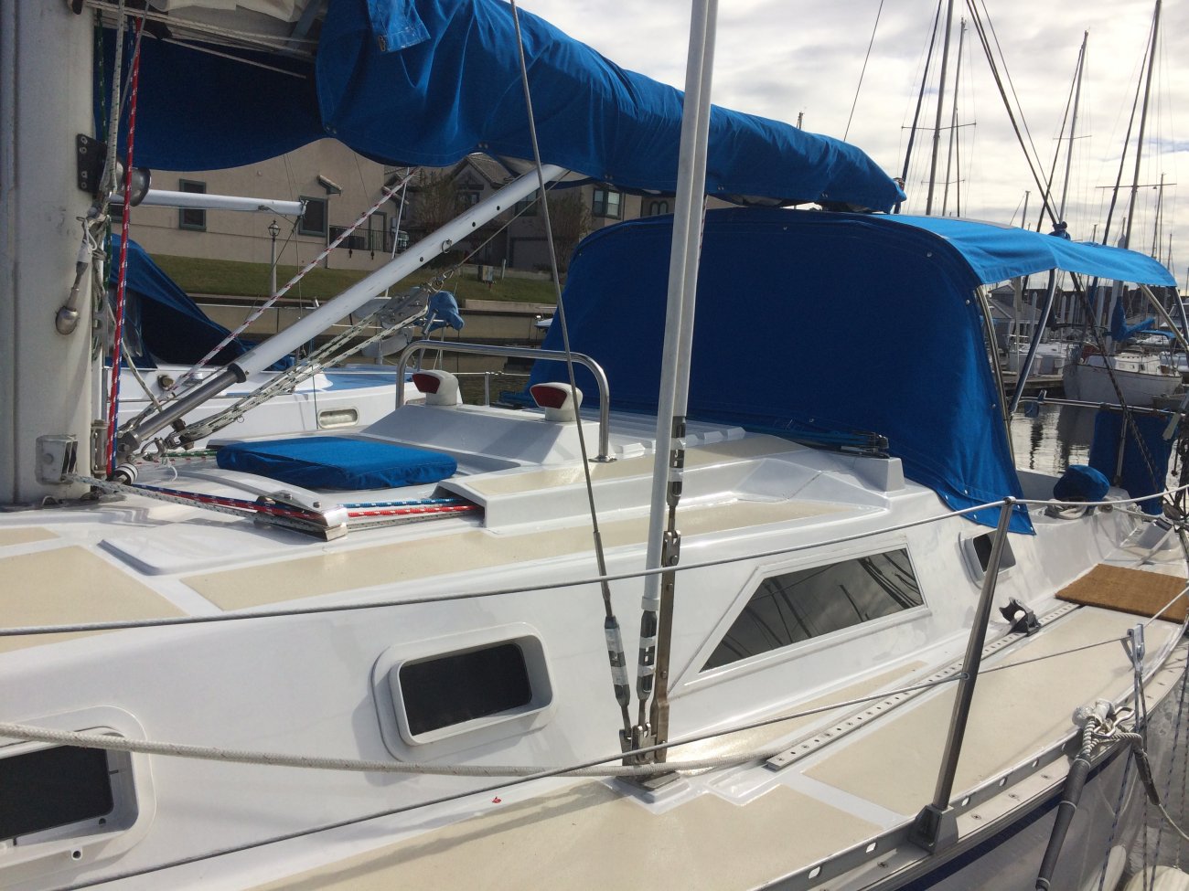

Am I seeing two cowl vents on a single dorade box in this pic??
Yes Gene. Mid eighties Hunter 28.5 / 31 and 34 have these. Unfortunately don't have an interior cabin pic of the dorade box vents.

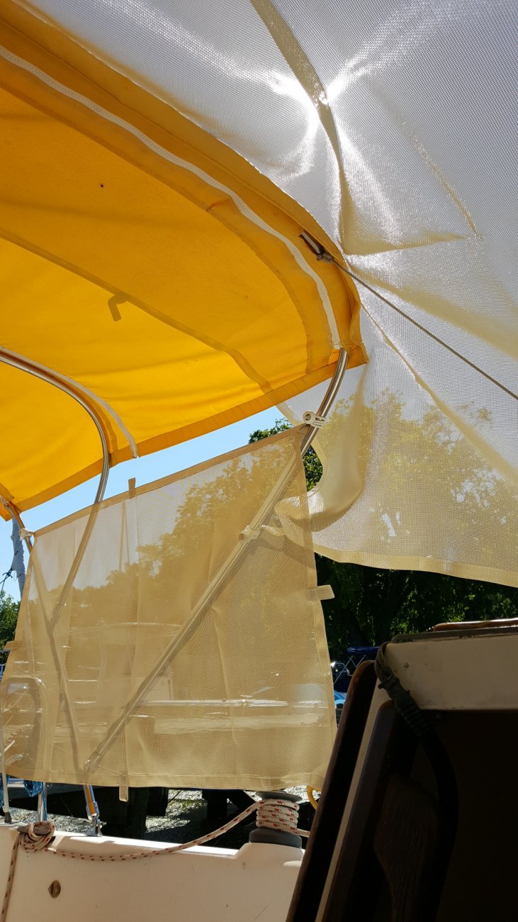

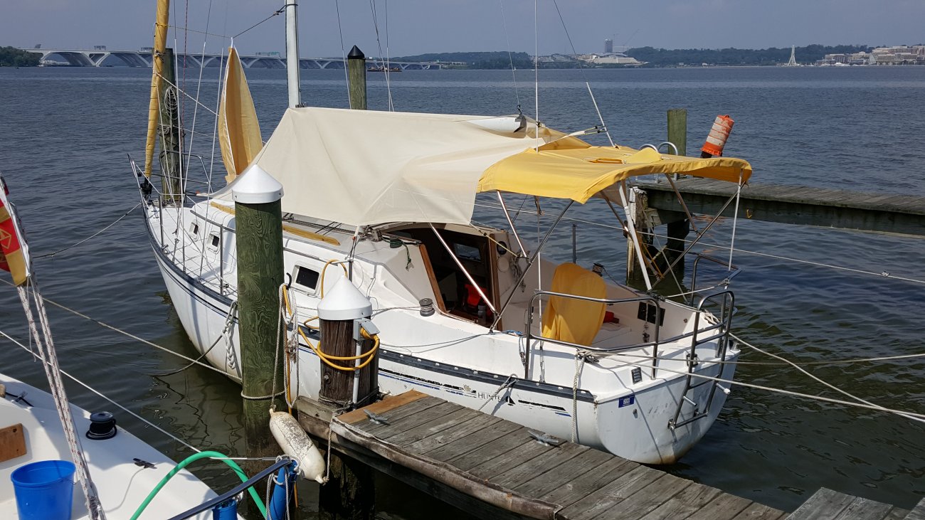

I made my sunshades out of Phifertex mesh, it blocks 70% of the UV without blocking the breeze, you can feel the difference when you step under it. Downside is when the sun is fairly directly overhead, the rays get through, so I am going to make a rectangular piece out of Sunbrella to put over the open companionway.

I would guess they are two different vents in the same box with a divider?

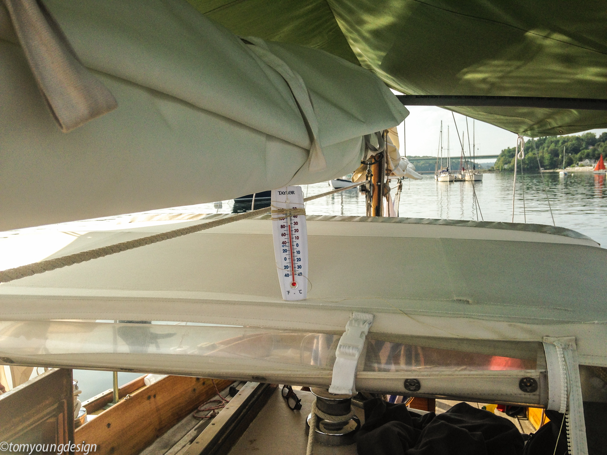

This photo was taken in Belfast Harbor on 9/3/15 at 4:03 PM. It must have been an unusually warm afternoon as I took the shot of the thermometer in the shade of the sun awning.
As long as I can get out of direct sunlight in extreme temperatures, I'm happy even when it gets very warm on our coast.

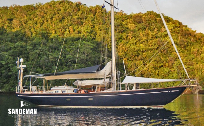

Tropical areas are where awnings are put to use. This boat has the typical awning over the cockpit, house and side decks. All protected in the midday sun. High enough to walk around beneath you could see it being very pleasant below with the breeze from the bow. Added is an awning over the forward hatch. Cooled air below plus protection from a shower. This boat also has a short bimini over the helm. Experienced tropical boat.
Only I know the protection will be minimal in the afternoon hours. Maybe they have side curtains?
