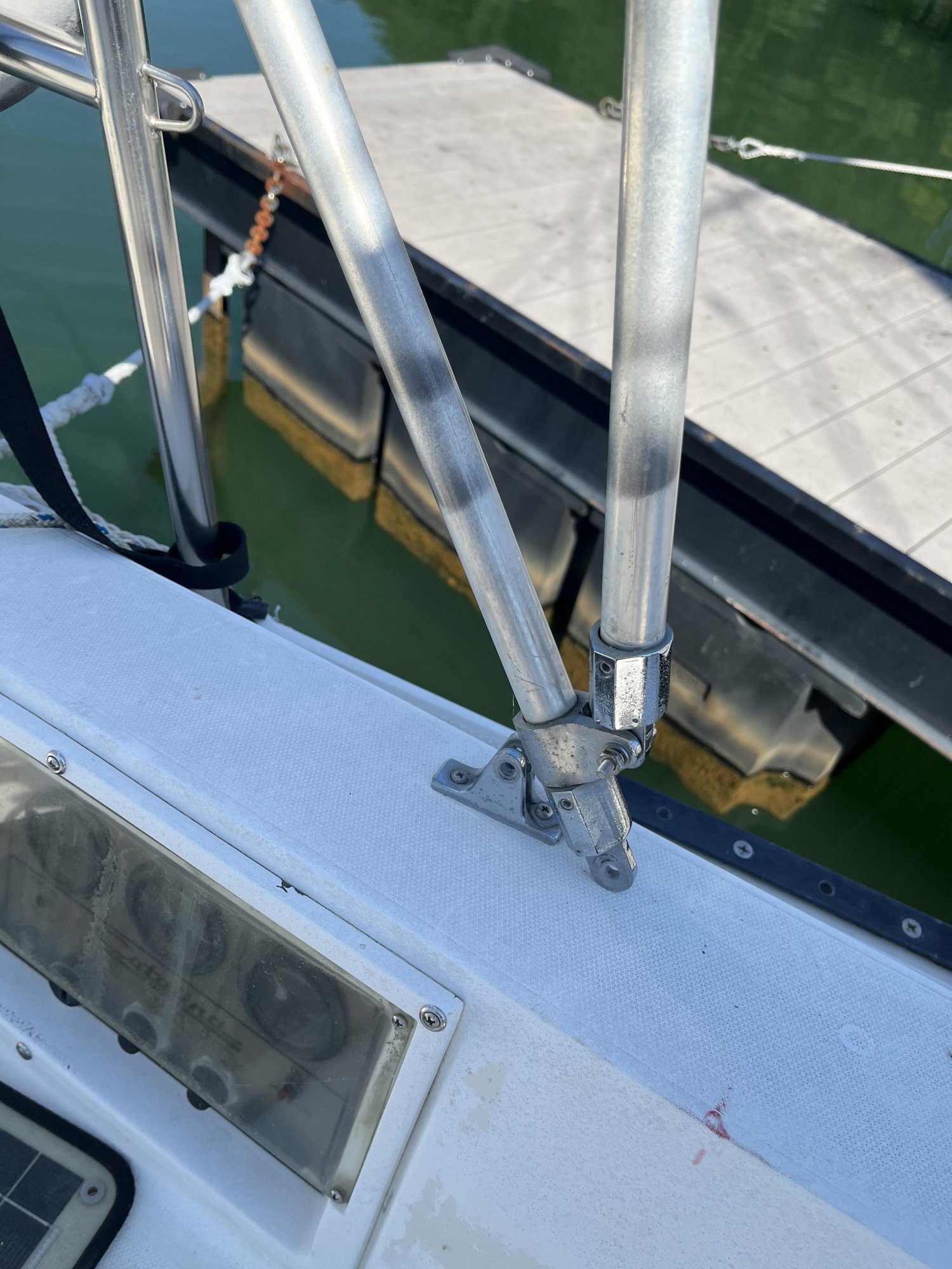

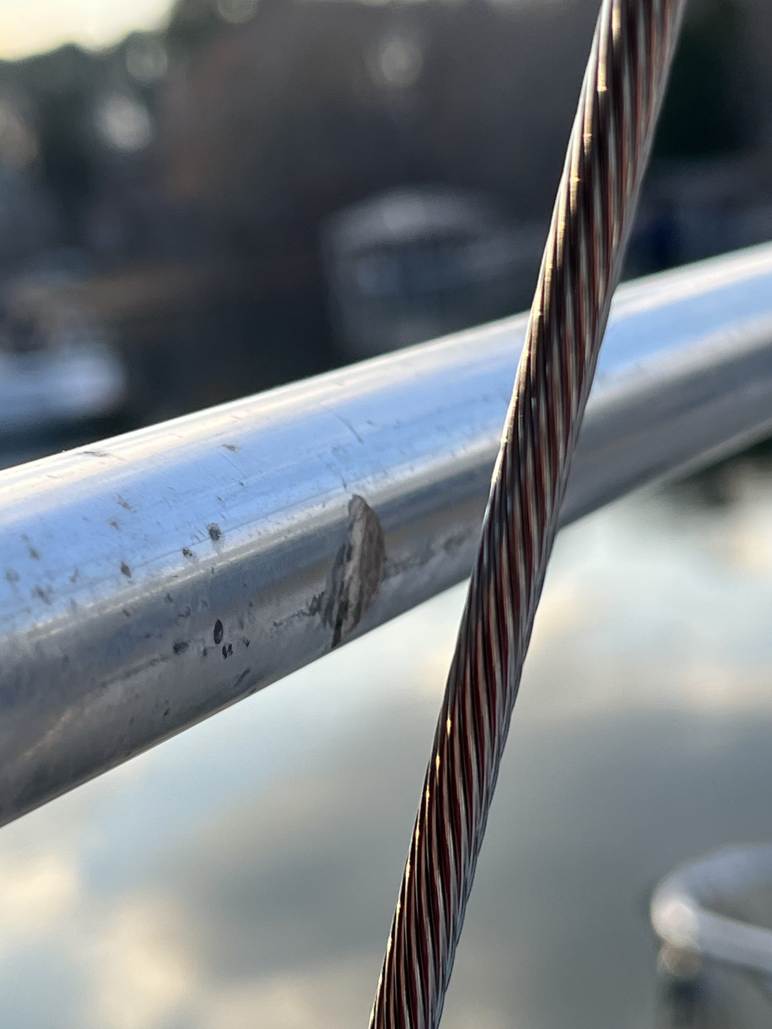

My bimini 7/8 Al tubing is chafing against the back stay. Two tubes, when closed, sandwich the backstay, and both have damage.
I can probably ignore the damage though if there is an easy fix, I would like to. Maybe cut it and reconnect with a coupler?
I certainly want to stop the chafing. Something that fits on the stay or the tubing. Shroud covers? I am not sure how long they would last against the now-rough-chafed tubing. Or some clam-shell installed on the backstay that would present a larger diameter to the tubing?
I searched on this forum but did not find. I would think this problem has occurred before.
Any recommendations are appreciated.

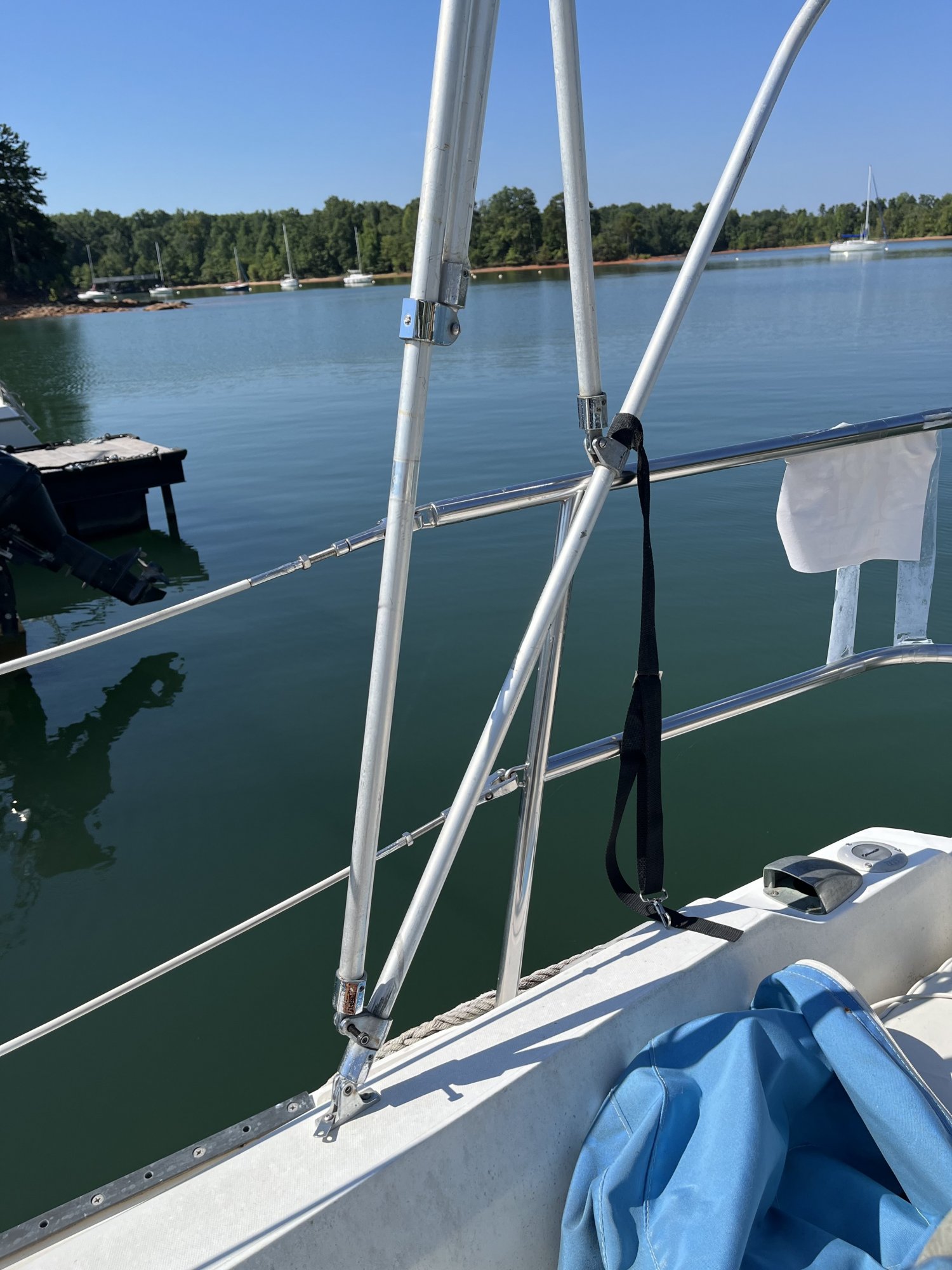

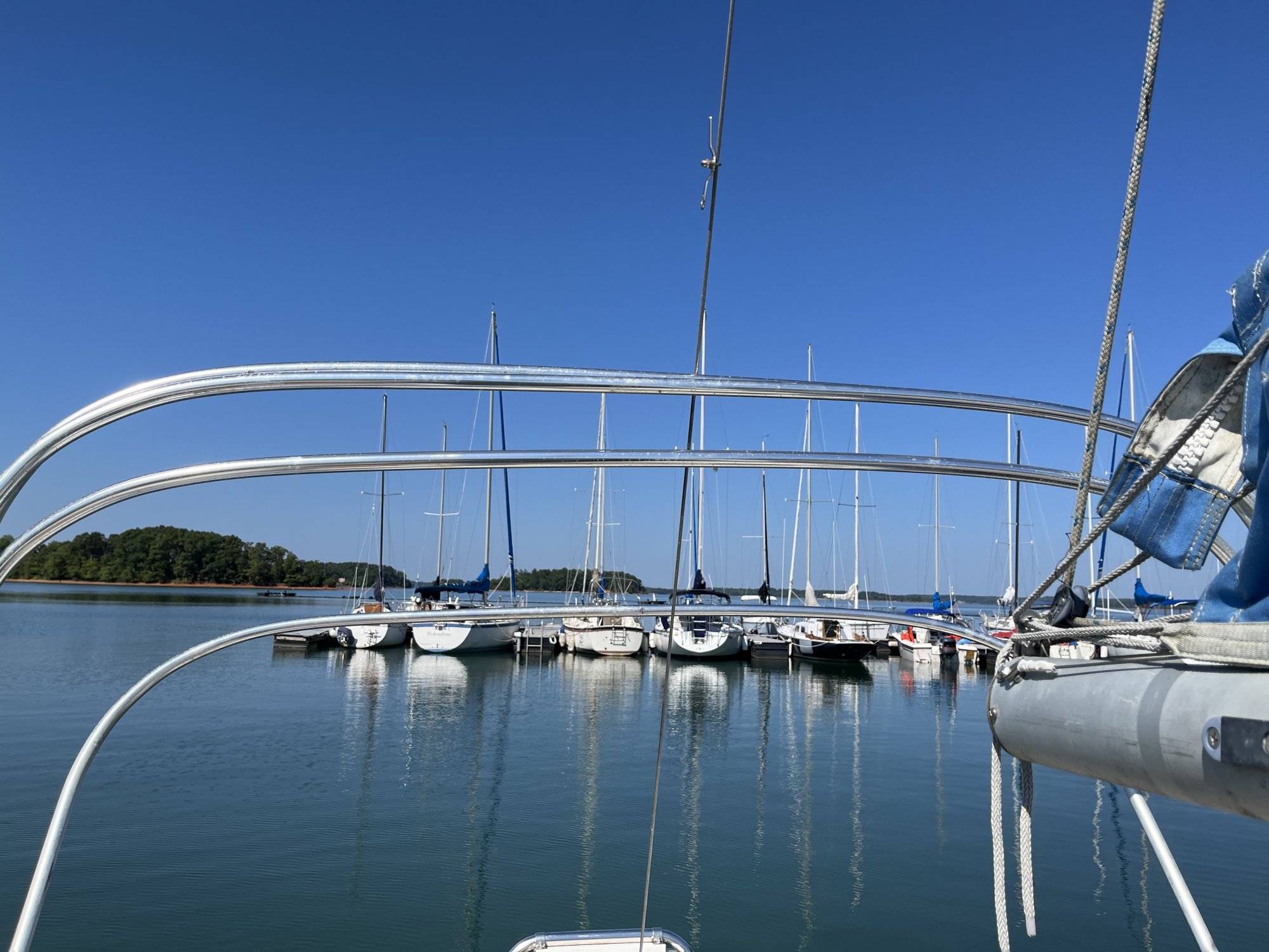

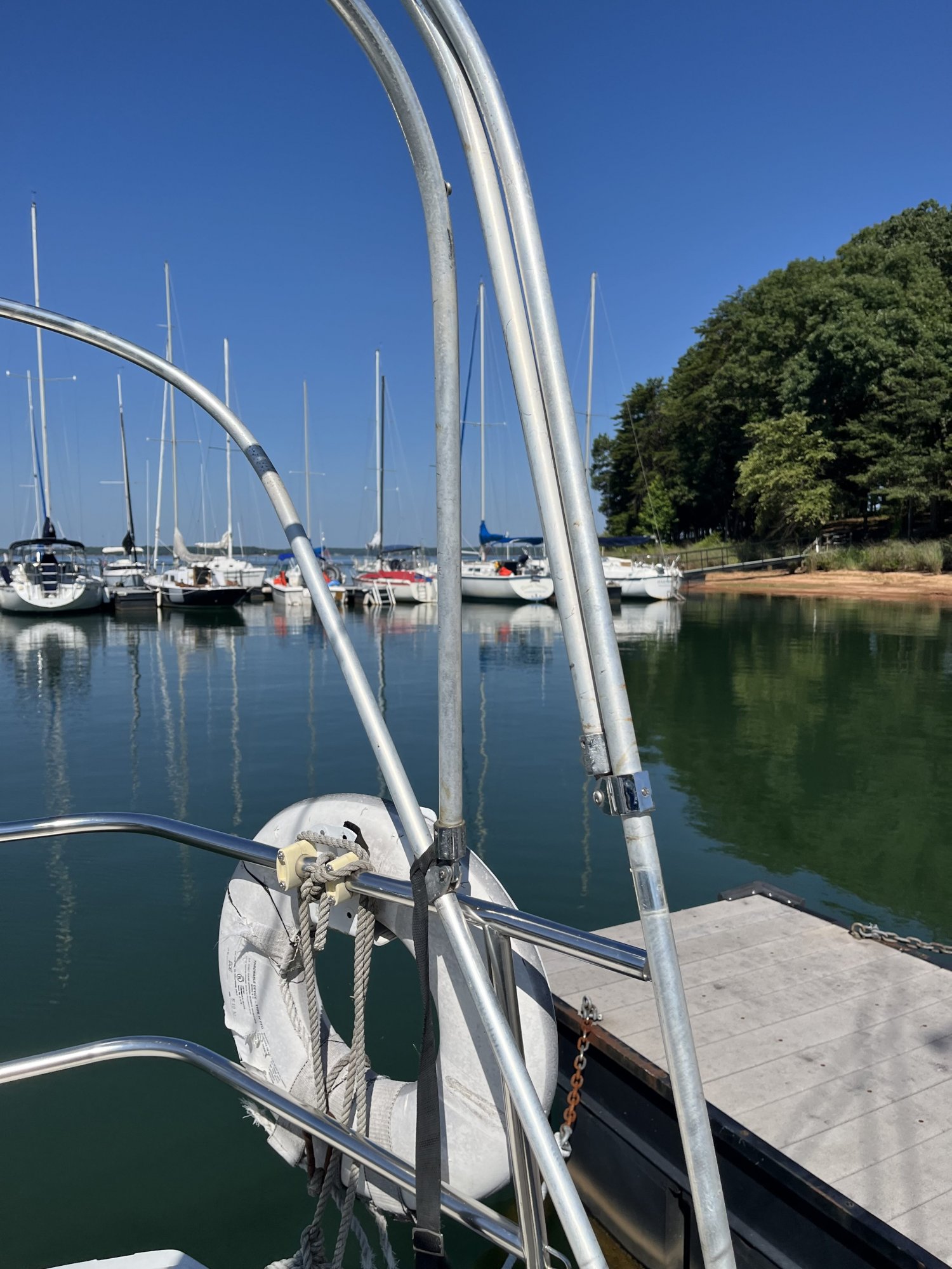

There are 4 tubes that fan out from the lower half of the assembly.
The tube furthest aft is aft of the back stay.
The other tubes are forward of the back stay.
When closed, they sandwich the back stay.
These are some pics from when I was removing the bemini, so you will see some fittings not made.
14,278
Thanks for the photos.
If you push the lower fittings for the forward bow up, it will push the forward bow towards the boat's bow. The canvass will then be pulled forward bring the aft most bow forward away from the backstay.

I found this and put it on the damaged areas.
7/8 ID dicharge tube
It cuts easily with a razor blade. I did not need to use zip ties, though they would close the gap.
On the backstay, I have some shroud cover. I am hoping the shroud cover and tubing material play nice. I might spray some dry lube on it periodically.
