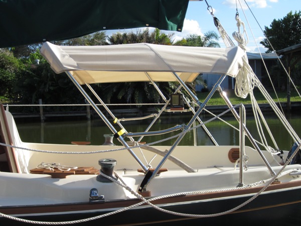

I didn't want straps to trip over so went with tubing and mounted the foreward braces horizontally to keep the winches as clear as possible.
Tracks are a great option as you can shift the bimini to cover the area of the cockpit in use at the time. As for mounting, just make sure it isn't in the way of the mainsheet.
