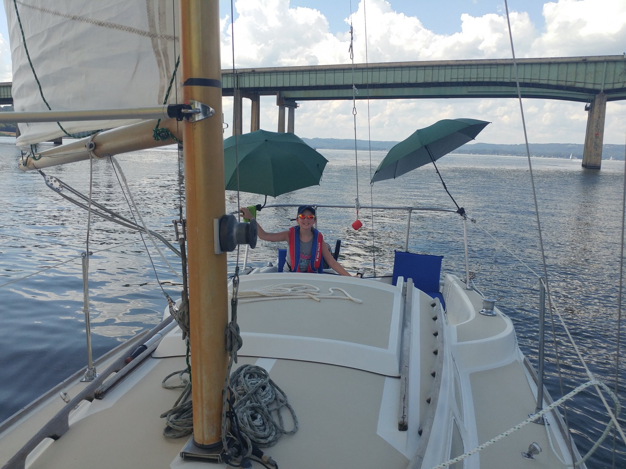

Get a gust buster large umbrella. It won't invert with wind. Allows wind to pass through. I tie one on the stern rail when I take the dog with me. He gets shade, not me. There is no room for a Bimini on a Capri 22. Hat and sunscreen per my picture.

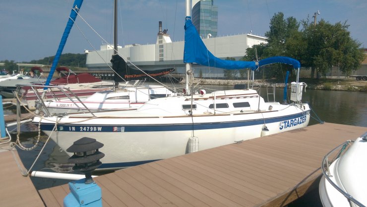

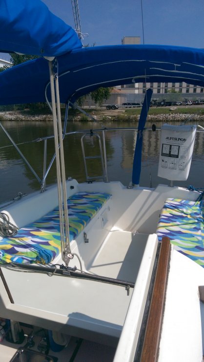

I have a professionally made bimini on my O'Day 25. It's a total game changer. Different experience but we feel a lot less fatigued when we use it. PO said he wish he had gotten it years ago. He paid $1100-1200. No issues in heavy winds. I fold it up when I'm away from the boat to keep bird poop off of it. I have it dry cleaned once a year for $15.
The boom is very close to it and must be pushed up a bit when I fold it up
I know a couple that adapted an off the shelf bimini for their O'Day 25. They said getting the hole in the right place for the backstay was a bear. PM me if interested. I have a couple of ideas to make that task easier

You can see how close it is to the boom. The sail cover actually touches it. PO stated that most canvas shops passed on the job. We went through some rough weather one day last year. The next morning I remember saying, "Imagine if we went through that without the bimini"
