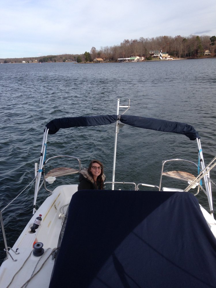

This is my Bimi when tied up in its cover. I can drive just fine with it like this and I don't even have the two screws that Captain Ron 18 mentioned. I just launch and if I get hot, I open up the bimi. Like Ron said, it is good money. I've put bimis on three different boats I have owned and if the H26 had not come with one, it would have been the first money I spent. You can also see the two blue straps that hold it forward. I have two eyelets on the cabin top. I just take the cover off, and take those two straps to the eyelets and I'm deployed.
