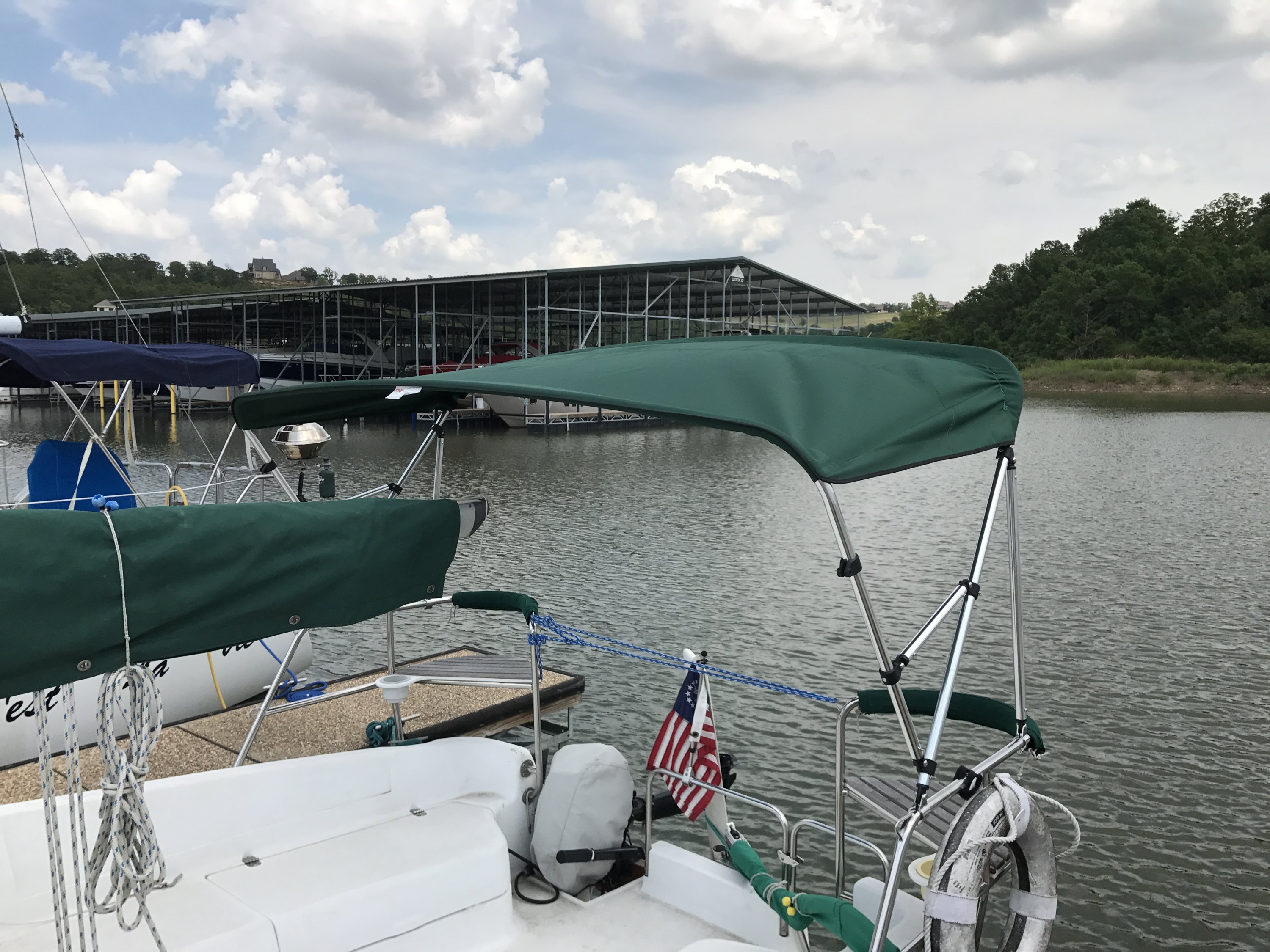

Thanks for everybody's responses! I took the gamble on bought a Chinese made $220 bimini for a pontoon boat and modified it to fit the Hunter 23.5. Lots of cutting and fitting, still need to make some minor adjustments to the fabric.
Overall a good result. I'll try to post a picture.
