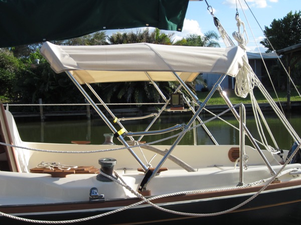

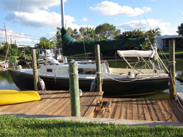

I had the issue with clearance and decided my best option was to find or have made a bimini that was shorter than the cockpit.
I've been on boats where you have to crawl out from under the bimini to go forward and hate it. One guy I met has his crew climb out the forward hatch as he didn't even have room to squeeze out between the aft end of the cabin and the bimini which is a big PITA.
I was able to pick up a complete bimini for a ski boat (SS frame) that was very close to the dimensions I was after on CL. Had a local canvas shop make new canvas in an acceptable color (wifes input) in Sunbrella and am happy with the result.
I can't stand up under it but can see fine over the cabin and can flip it back by pulling 2 pins from the horizontal supports.

Thanks all - especially merlinuxo who sent a picture. I think I knew these were my options but wanted to see if there was any magic out there. Perhaps I'll try to do a little of both. I'd like to be able to stand up- an issue for me all around on this boat, and I also don't want to have to crawl out from under the front. It seems reasonable that I'll need to shorten the sail and perhaps not try to cover the entire cockpit.
