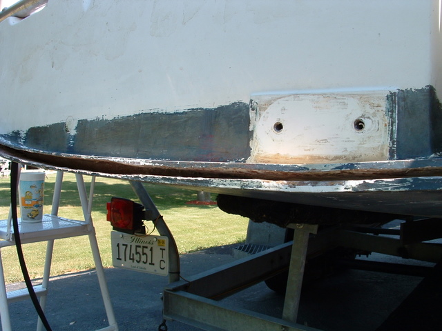

Possible leak location
Do not ever sail with the ballast tank less than completly full!
I had a leak through the stern joint where the deck and hull are joined. The glue had hardened and cracked but was invisible from the outside. Water would come in only when the boat was healed and the joint was stressed. I had someone laying in the stern bunk and they saw the water coming in while sailing. Once at home I took the air gun from the compressor and pushed air into openings in the glass while laying on the stern bed. Water came out of the joint in a 3 foot area. I had to remove and reglue over four feet of the joint. I used bondo/glass and it has not been a problem since.
