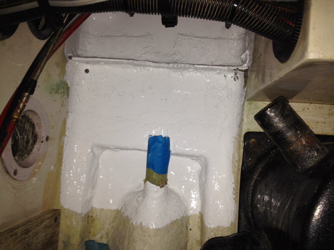

Jeff,
Can we be clear on which bilge you mean, as always pictures would help.
To me when you say the aft bilge, I am thinking of the section between the engine and the shaft seal. I have a small glassed in wall separating the aft section from the section under the engine. See picture with shaft log covered with blue painters tape labeled "aft bilge". I have found the holes in this section to be crusted up and not draining. I cleared the blockage with a screw driver and then flushed with fresh water and have not had the issue since I switched to a PSS Dripless.

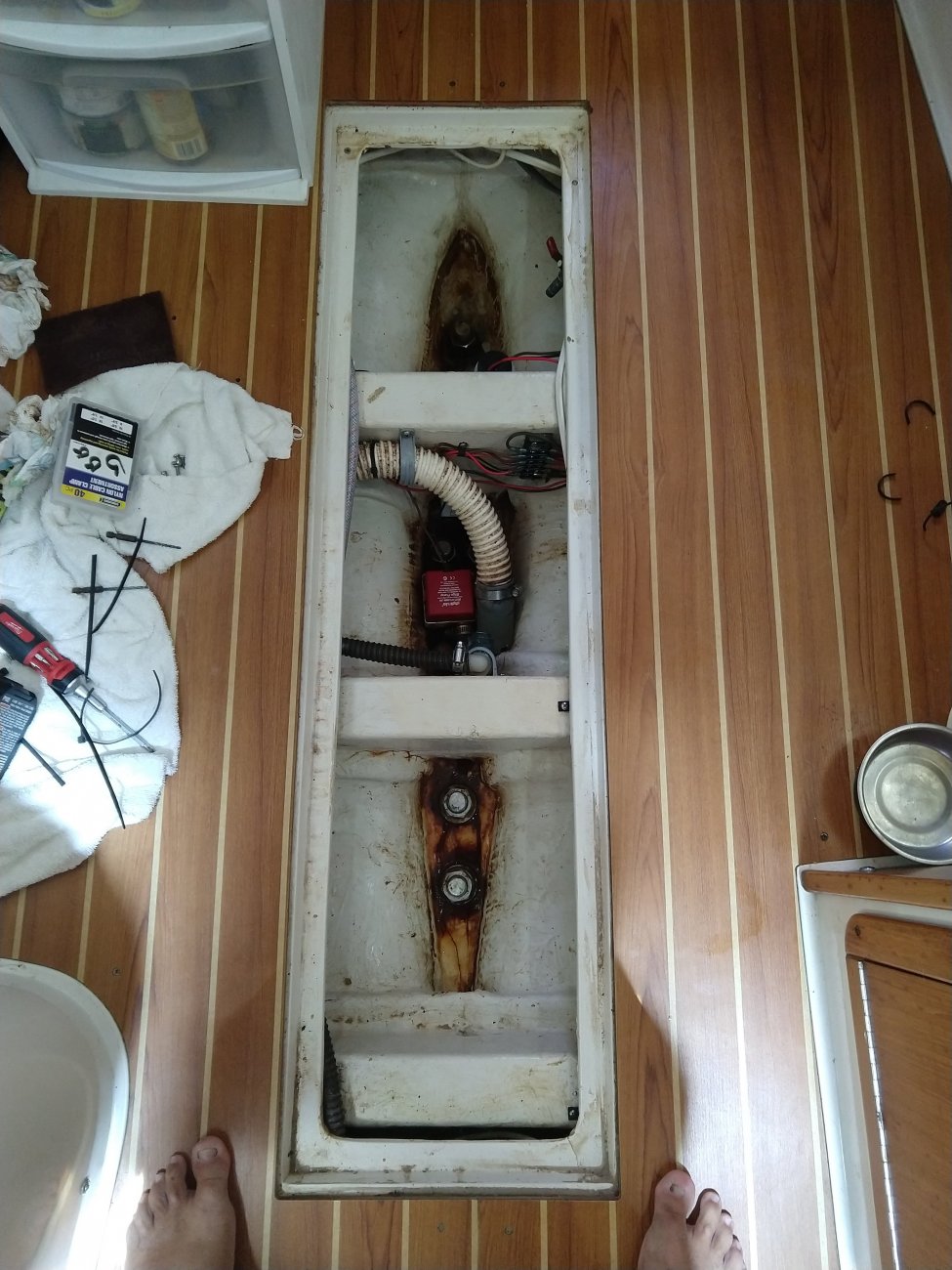

Or do you mean the aft section of the main bilge area where the keel bolts are located. The bottom section in the second picture labeled "bilge".

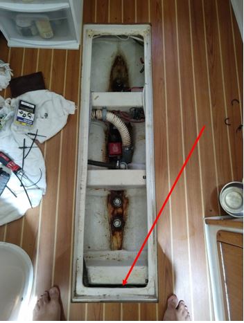

Hi
Actually the "bilge" compartment that annoys me the most is the one yet aft of the 3 bilge compartments seen in your picture (see pic). This is usually dry except when I empty the water heater, etc. But I would like that all the bilges drain into the one with the bilge pump so there is no standing water in any of them except for some residual in the bilge pump section. Your stringers are different than mine; they are much thicker and higher. I wouldn't want to drill through one of those
