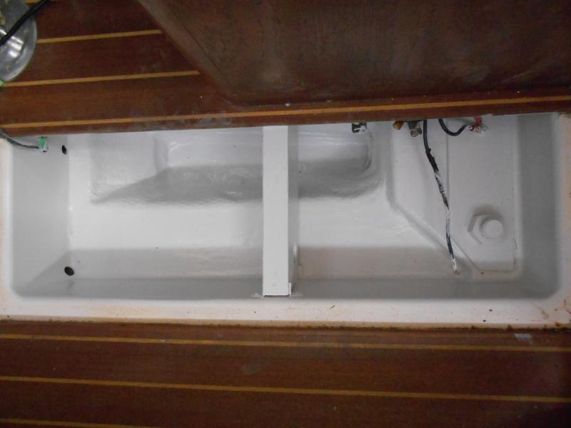

Don't procrastinate like I did trying to avoid the issue. After reading all I could find on the subject and seeing what the guys on this site had done (Thanks Allan and all the others), I finally took the plunge and did the job. Not bad and my boat now has a very pleasant odor because there is nothing rotting in that bilge anymore. I took a bunch of pics while doing it so I put the attached together to help you and others who want to tackle the project. Credits for the original drawing have to go to Neil Delisanti who had posted it on this site. Good luck.
Claude
Thanks for info and the pictures. I printed them and will use them for the work. I am still nervous about cutting/drilling. Don't understand the "Hunter made holes" depicted in the drawing.
Dec 14, 2003
1,446
Claude
If you lift the floor section that covers the bilge area, you will see 2 holes high up in the front section of the bilge. One normally has wires the other is for water trapped under the liner to flow to the bilge area. Now stick your head down and look under the floor on both sides of the bilge. You should see those "Hunter made" holes I'm talking about. They are about 1/4" too high and consequently allow water to be trapped, leading to bad odors. The pics here show the front one and one in the front port corner. There are also some under the floor section on the starboard side.
