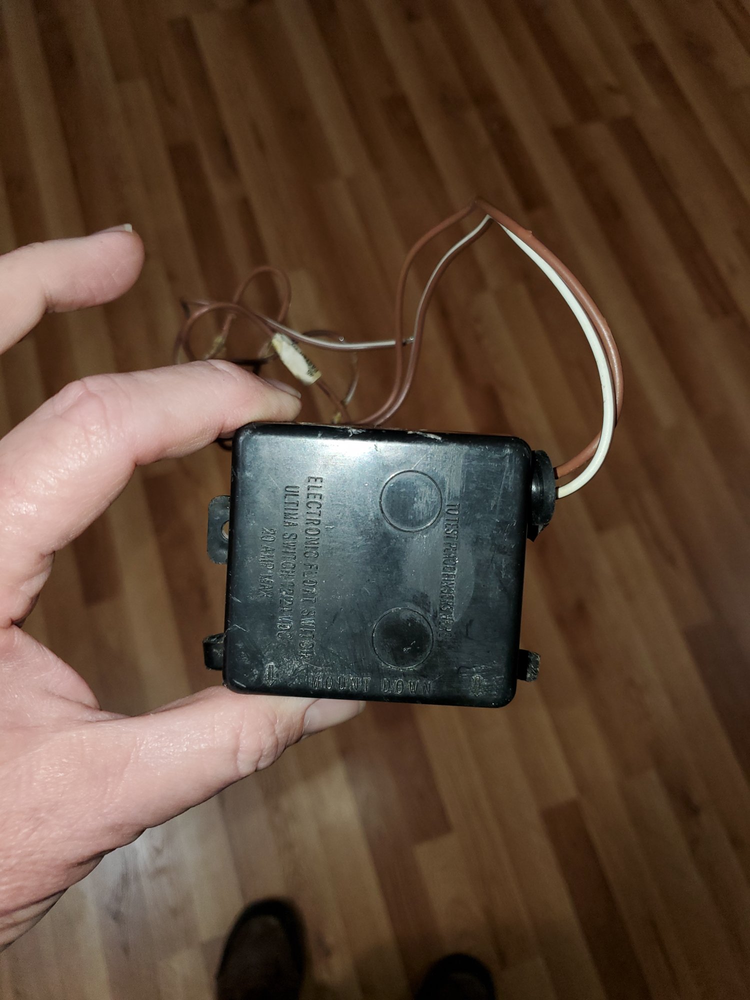

I have never been able to trigger the bilge switch on my new to me Beneteau Oceanis 31. It looks to be a Johnson Ultima. I tried cleaning it, shaking it, and flooding the bilge with water. It seems to be defective although I have not checked the wiring yet. The pump does work in manual. The space I have to work with is limited. I am considering replacing it with the same Johnson Ultima switch but I'm concerned about its' reliability. I have used a Water Witch switch in another boat, it was fine for the five years that I had it. The Water Witch should also fit into the available space.

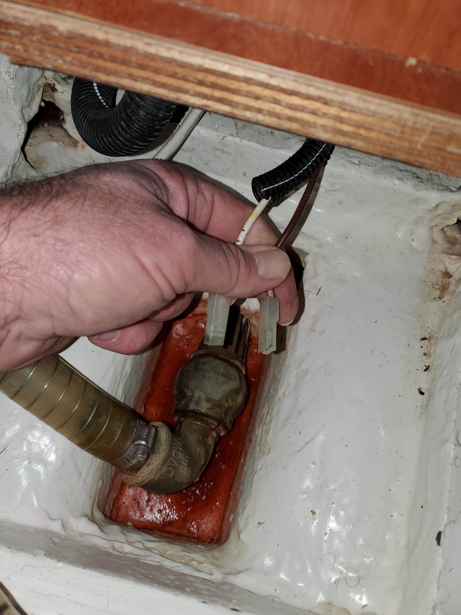

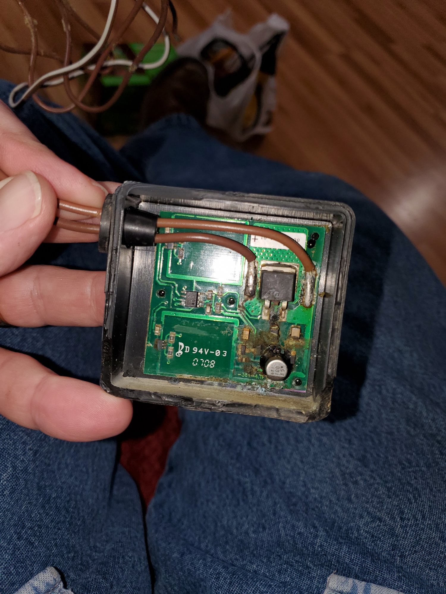

These are the connectors that Beneteau used to connect the bilge switch. The other ends, on the switch, were somewhat corroded and they pulled off easily.
I really thought connections in the bilge were supposed to be water proof.
The switch is bad.

Yeah, probably isn’t supposed to look like that inside.
They used similar looking spade connectors on the 37. The connectors sit high up in the bilge, above the sump area, so if water gets that high it means the bilge pump isn’t keeping up anyway. Still, you’re right that it would be nice to have something more robust there.
Jul 23, 2009
926
The connectors were pretty low in my boat. I will at least pull them up higher and secure them.

If those connectors ever drooped into bilge water they could set up a galvanic current that would corrode away your prop and thru-hulls in a remarkably short time. Bilge pump wiring is the most common reason for this corrosion. Always replace a pump or switch if there's any possibility of a crack in the insulation exposing bare copper to bilge water. Keep any splices far above the water surface.

Jul 23, 2009
926
Galvanic corrosion was what I was worried about too. Glad you said something.
