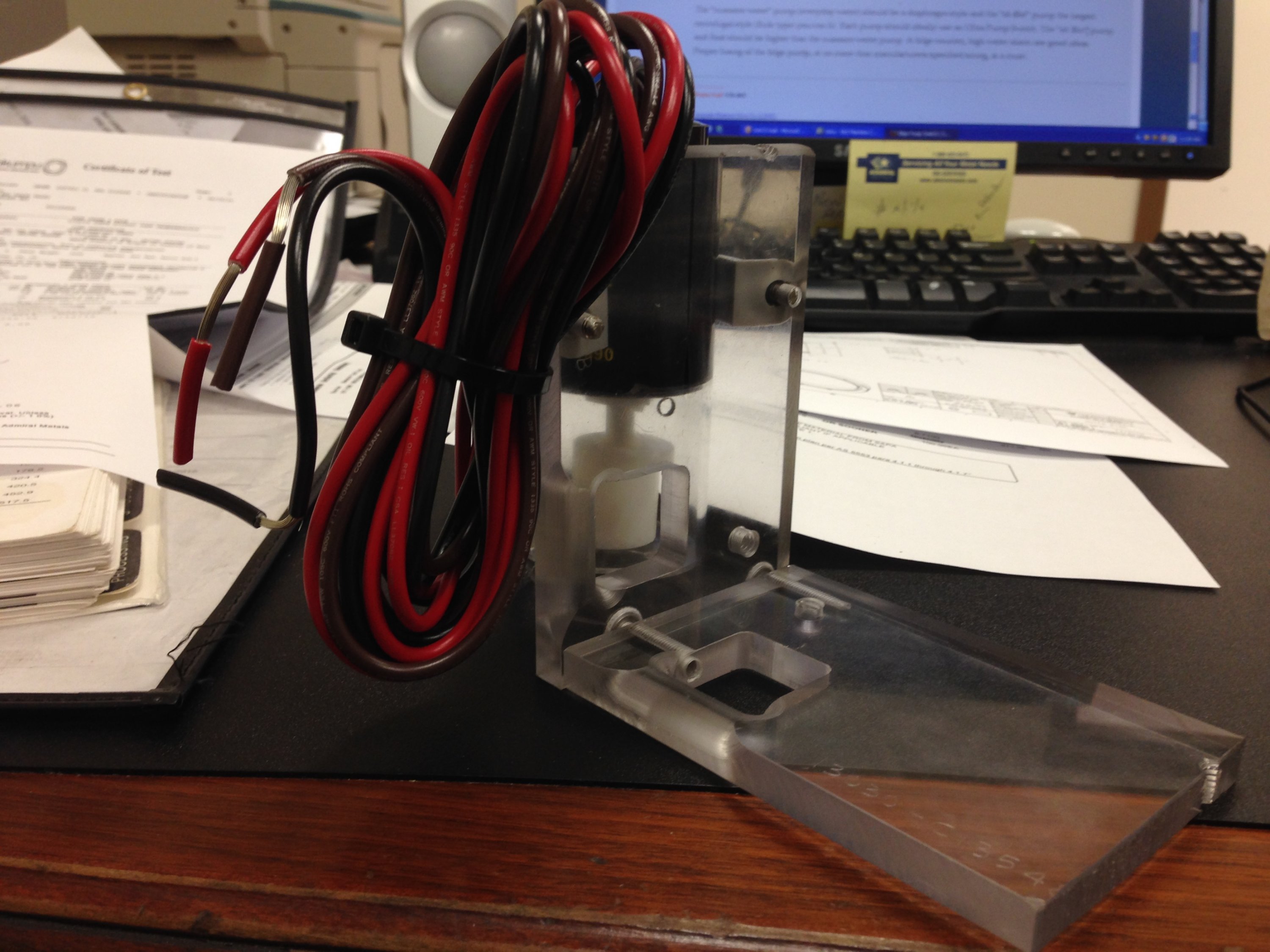

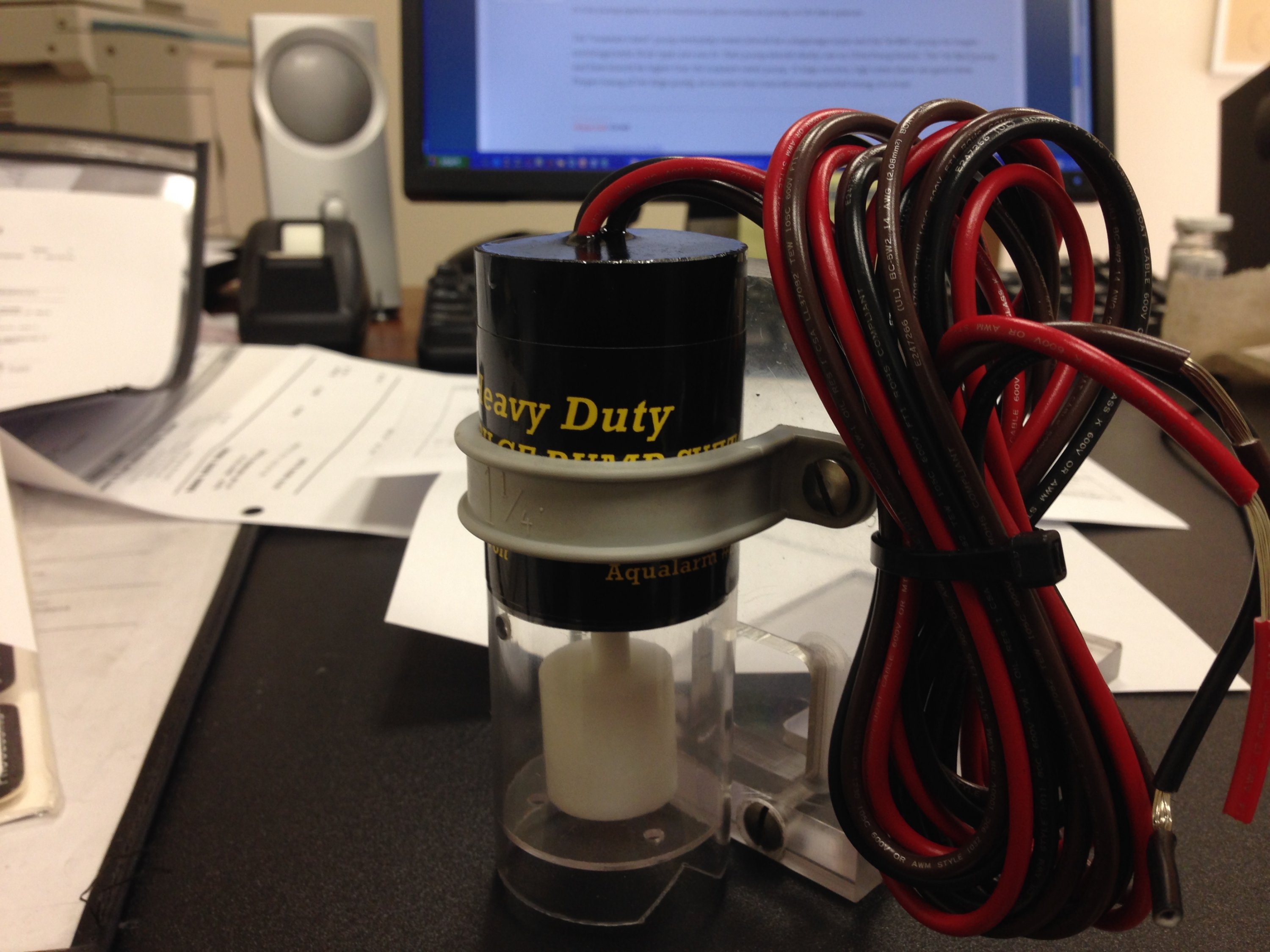

Well my Rule switch passed away over the weekend. Came to the boat to hear the pump running continuously. I shut the switch off and toggled the switch and it seemed to work correctly. Now it doesn't work at all unless I run it manually.
Anyone familiar with the Aqualarm heavy duty bilge pump switch? Defender sells them and I was going to pick one up.
any insight will be appreciated.

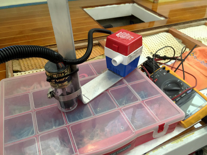

Bob S
Sep 27, 2007
1,813
Beneteau 393 New Bedford, MA
Thank you for replying. I will be ordering the Ultra Pump Switch. I already bought the Aqualarm. I wish I held off a little more but I haven't had a functional switch and jumped the gun. I made a Lexan bracket but I like your bent aluminum. I was worried about electrolysis with the SST keel bolts. An area I don't quite understand yet :)
