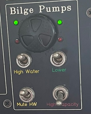

Perhaps larger concern is the "off" position. You must develop habit to always turn back to Auto position after in the Off position; otherwise, pump will not turn on automatically. I have a "Depart the Boat" checklist that I review every time I leave the boat. Yes, I have inadvertently left pump in Off and left the boat. Couldn't sleep, took midnight drive back to boat to flip to Auto. I've also driven back to boat because I didn't remember if I had left it in Off. That's why I now have a checklist. Not good if long drive-time back to boat to flip the switch. I wired my pumps (on)-off-on with an green LED when in auto position and red led when pump is running (either in Auto or On). Quick glance tells me if in auto position (green led on) or not. Also, quick glance tells me if pump is running (red LED). The alarm is for the 'high water' pump, which is about6 or 8" higher than the pump at the bottom of the bilge. "Off" comes in handy when pulling the pumps to clean/maintain or when I am running fuel polishing (If polishing hoses leak, won't automatically pump diesel overboard. BUT... it is risky if you are not disciplined.
