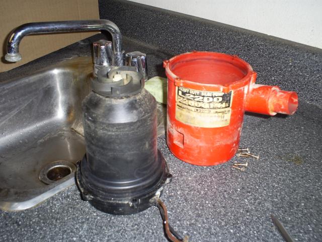

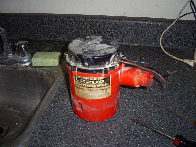

The bilge pump quit working. Probably because it's filled with water. West has them listed near $100. Is there any saving this thing? If so how do I take it apart?

It's a bilge pump - why would water hurt it? ;) I guess it got into where it's not supposed to get - wiring connections corroded inside maybe? As for taking it apart, find any screws you can and unscrew them. It's a good Alzheimer's test as well.
In the end, it might be worth the $100 to replace it. Remember, West Marine is not the cheapest place by a long shot.
It's toast. Don't try saving it because water leakage through to the hot part of the circuit can do a lot of damage to your boat.
Buy two new bilge pumps mail order from here. Get one of the largest capacity that has an outlet that fits your current hose size and mount it about six inches higher in the bilge than it is now with the float switch at about the same height. This one will stay dry and unused unless it is ever needed to help save your boat. It will last forever that way.
Buy a small one with 5/8 or 3/4" hose to take care of condensation and other normal water collection. This one can be cheaper because your boat isn't ultimately depending on it and you'll need to replace it every couple of years since it gets wet. Yes, water destroys bilge pumps. You'll need to drill a new through hull for it or you can put a "Y" in the existing bilge line right before it exits from the boat and a reducer on one leg to take the discharge from the small pump.

Please forgive my ignorance. I thought bilge pumps, or at least some of them, were submersible. The one I have in my Whaler, a manual 500 GPH, has been under water after a rainstorm, leaving the plug out, etc., and still works. Am I just lucky?

I will pitch the coconut and get two new ones as recommended. Thanks.

I think that the water is in the "sealed" portion of the unit. Yes they are submersible but you will not find to many electrical motors that "run under water".
Bite the bullet and find yourself a new one. Most of the bilge pump a good for a few years and all of a sudden they are history. I am working on a similar issue with the float switch in a Rule pump with an automatic float.
