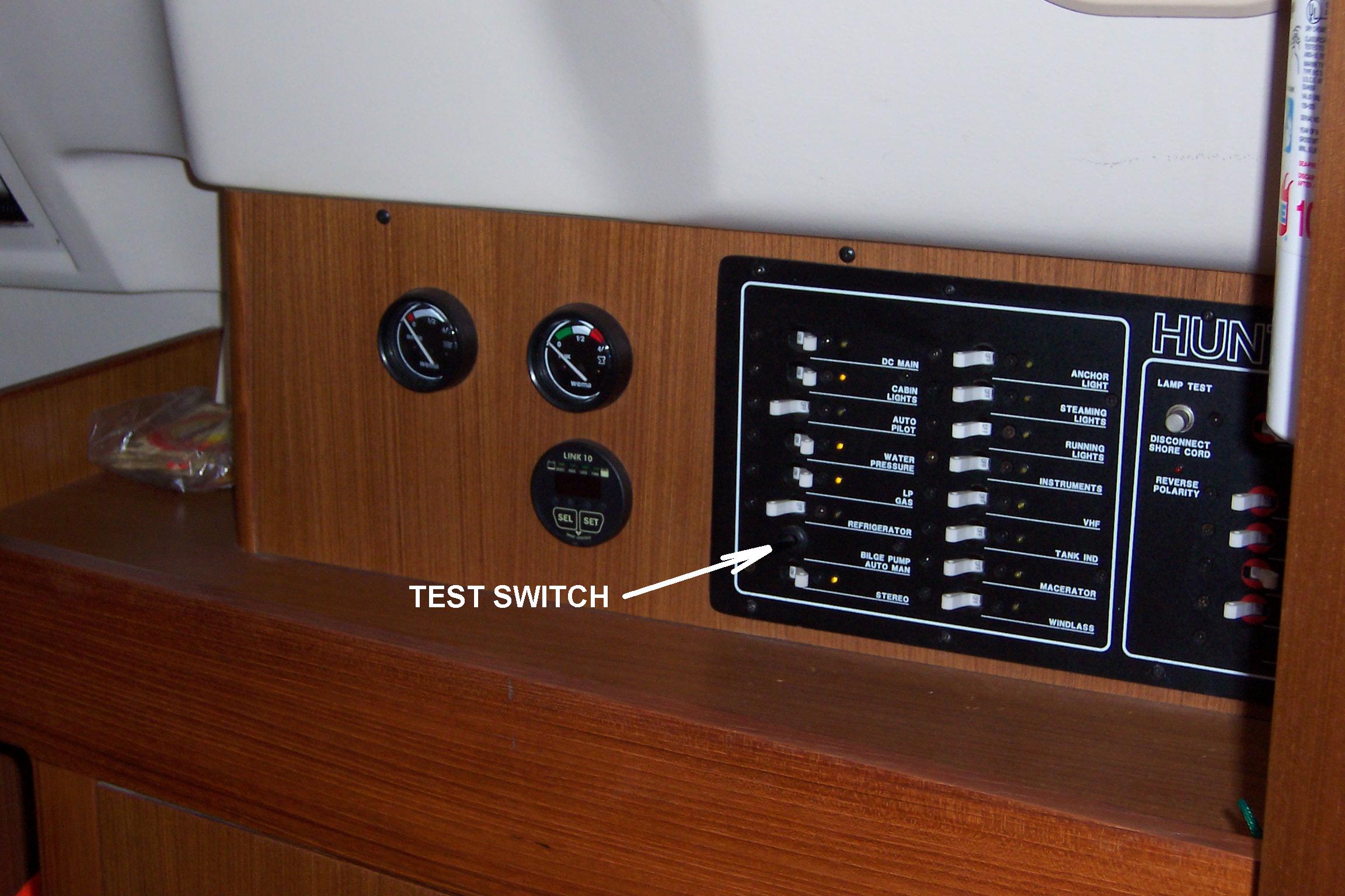

I was winterizing my 30T today. The boat is new to me. My hot water tank drain line runs to the bilge in the center of the boat where a bilge pump sits. This pump is wired to the Hunter switch panel on the port side to a switch labeled appropriately 'Bilge Pump'. The pump comes on when you flip the switch and stays on until you turn it off. Shouldn't there be a float switch so it can be left on to engage if/when needed? Is there another pump on standby in the 30T (1991).?

On our boat, the switch you refer to is strictly a momentary test to see if the pump runs even when dry. There is no shut off switch to the pump as it is (or should be) wired directly to the battery with a fuse close to the battery.

On ours we had the same problem.
On our bilge pump there are 3 wires
The one connected originally goes directly to the pump motor (originally this was wired to the circuit breaker. It goes to the wire to the test switch)
The open wire was the one going to the float switch and then to the motor (This should be connected to the circuit breaker)
The 3rd wire is the ground.
All I needed to do to see these wires is open the floor panel above the bilge pump.
You just reminded me that I still need to connect the wire to the test switch.
