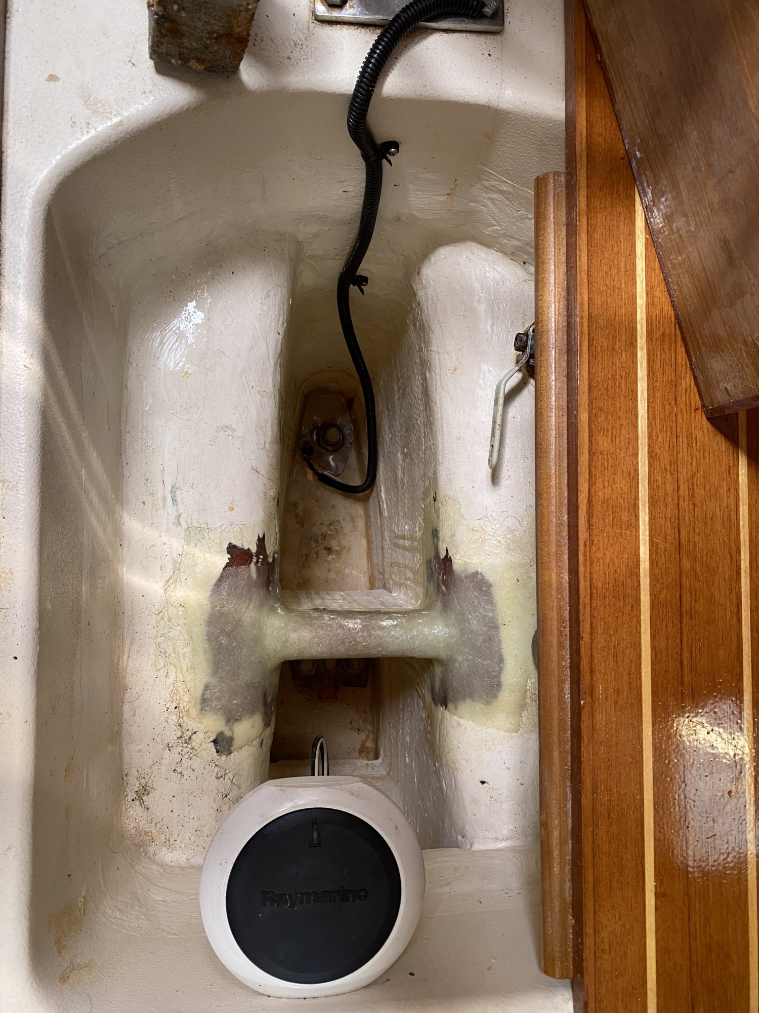

Pics if the keel “pocket” can be seen, below. The total depth is 32”. The height of the pump/float bracket is 19”. Too deep to deal with maintenance at the bottom of the pocket.
That is tight!
I like the removable mount idea for that setup…
