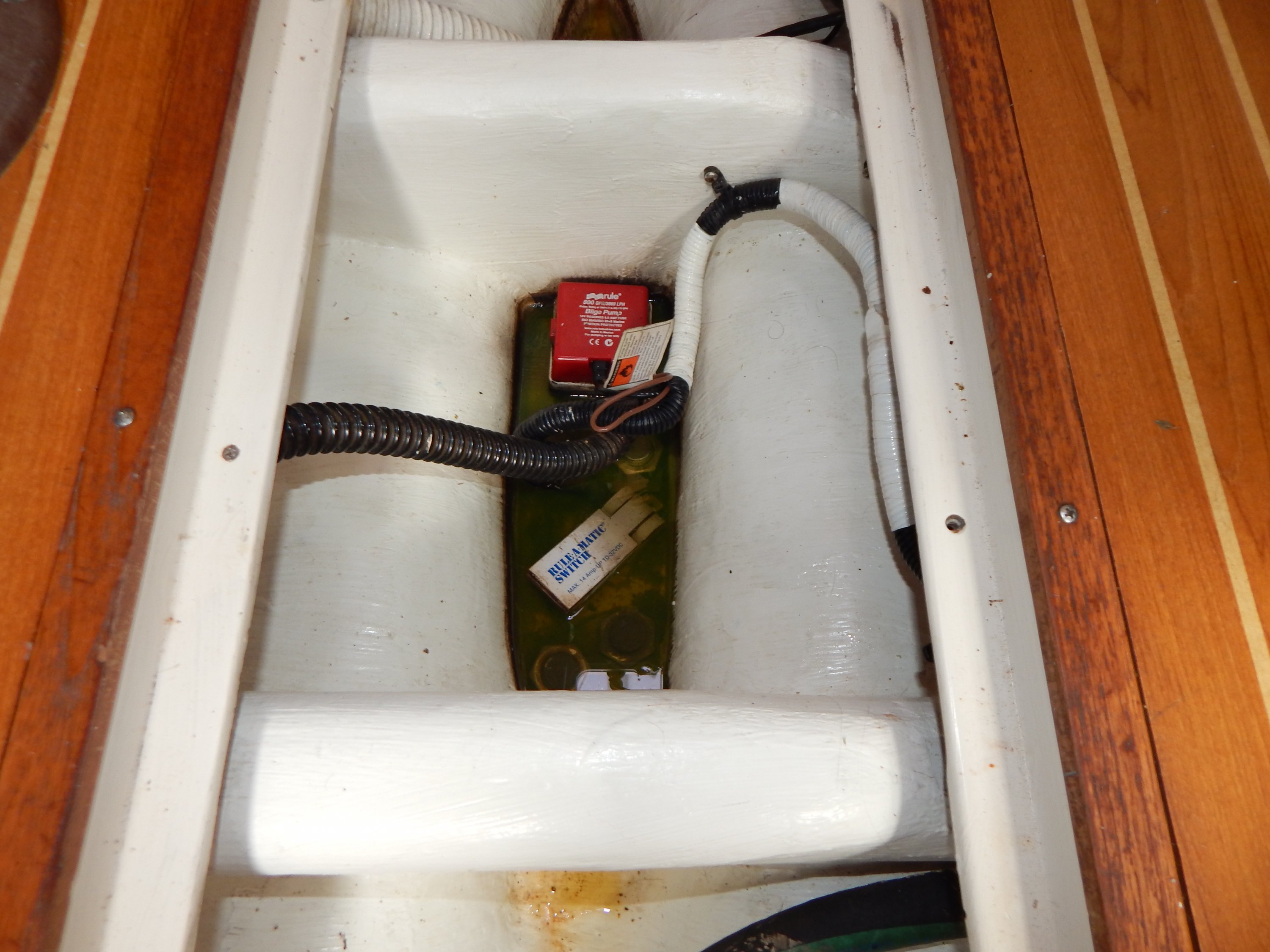

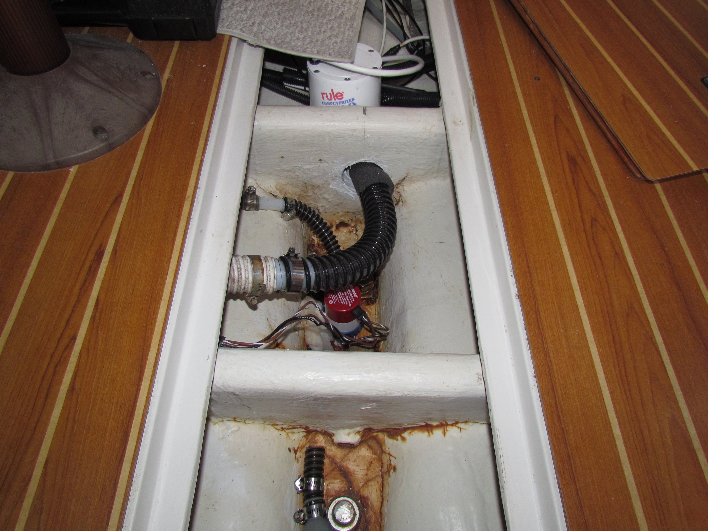

So, what make/model of bilge pump do 310 owners use and what do you use for a float switch? The 310 bilge is very tight compared to most boats. Pictures would be helpful.

What I have is a Rule Industries Non-Automatic Submersible Electric 1100gph with a Rule-A-Matic Switch. this has worked for the last 12 years with no problems and yes I do have some water in the bilge.
Are you willing to post a picture of the installation? It would be a big help.
I looked at the Rule-A-Matic Switch when the original bilge pump died. I couldn't figure a way to make it fit between the keel bolts with a Rule pump. I made cardboard cut outs and moved them around. I couldn't find a place for a clean installation.

The rule pumps will work. Not my favorite quality but if you just remove the check valve and replace it with a double barb it will work fine. Rule actually says not to use check valves on the pumps and their website.
If you want better quality, look at the diaphragm pumps. Whale pump makes one but it won't fit in our bilge. I used a Jabsco belt driven fresh water pump. They usually cost over $300 and have pressure switches on them. I found one at a consignment shop for $40. I removed the pressure switch and wired it through a float switch. I installed the pump under the port settee.
I will take some photos when I open the bilge next. But I am too tired right now. Just finished 2 weeks of hard work helping a friend recover from a lightning strike and adding 4 more solar panels to my boat. Just going to sit in the cockpit with a cigar and a beer and enjoy the Caribbean trades.
