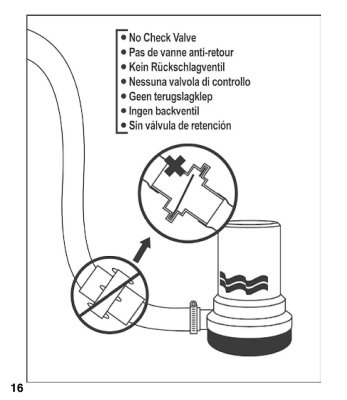

You didn't mention which sort of pump you are using, but one should never use a check valve with centrifugal pumps. Never, no matter the reason.
Any reason behind that ?
I've seen check valves on 1,000 HP centrifugal pumps all the way down to basement sump pumps. When pumping to a higher pressure, without a check valve, the whole works comes back into your lap when the pump shuts down.
I don't think a check valve is needed or desirable with a bilge pump as long as the discharge hose is horizontal.
I agree with Ralph. I have work on and tested pumps for over 40 years and the first thing I ask when I purchased a sailboat was "Why in the world is there no check valve on the bilge pump? It lets a gallon of water return to the bilge every time it shuts off."

Hey guys, let's not kill us messengers....
"If one does not care to follow the RULE installation instructions, which include a full page warning for no check valve, that is not something to take up with me on the net. It is probably best to take it up with Rule." _Maine Sailrule check valve.jpg
