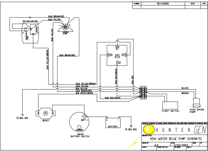

I believe that your boat may have originally come with (2) bilge pumps, (1) at the bottom of the bilge and another high volume pump up higher, the higher one working on a separate float switch and tied to an alarm should the float switch activate, you should also have a manual bilge pump which is operated from the cockpit with the handle stored in one of the cockpit lazarettes.

DayDreamer -- I see the single automatic bilge/float, and a manual pump. I don't see a second bilge pump in there, nor in the documentation. Maybe that came in the Legend format, or in 1986 or something?
Our high water pump is manually triggered from the engine console in the cockpit, there is also and light and a audible alarm should the high water float switch be activated. The pump on ours is mounted at the front end of the keel stub, under the cabin sole.
