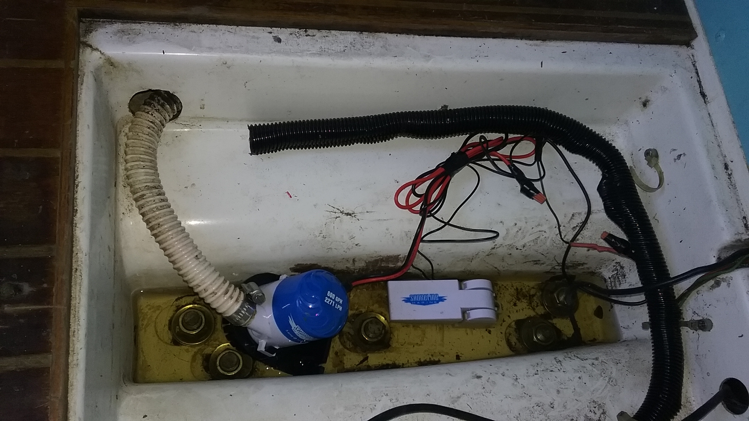

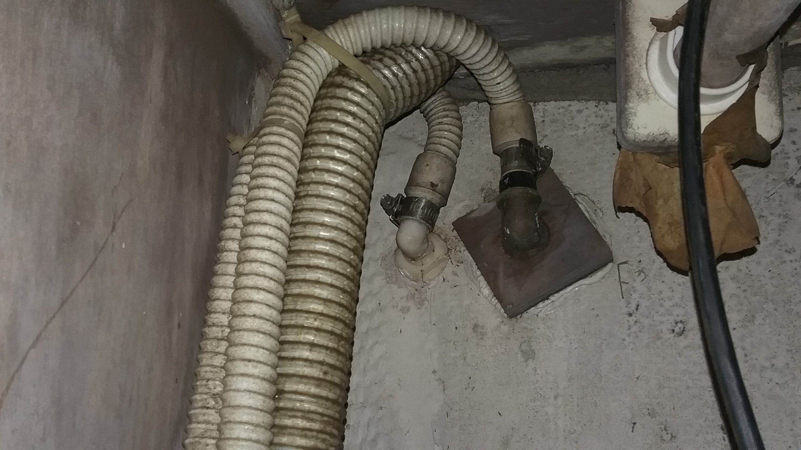

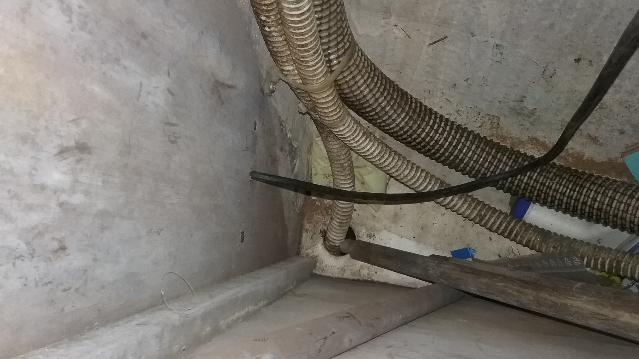

Jul 2, 2016
33
Hunter 26.5 Paris Landing TN
Here are some pics that I took today. Boat needs a good cleaning after the winter don't judge. The thru hull firing is plastic and the hose is that corrugated hose wire reinforced. I don't have any extra in the loop so I think it all needs replaced.
10,536
-na -NA Anywhere USA
I was talking with him when the photos were sent. As I suspected the bilge line ran between the floor sole and hull. He will get the hose from WM and I have suggested to tape a messenger line to the old hose to attach to a new hose to pull thru but suggested two folks. Hopefully he will, get me on the phone when doing this.
