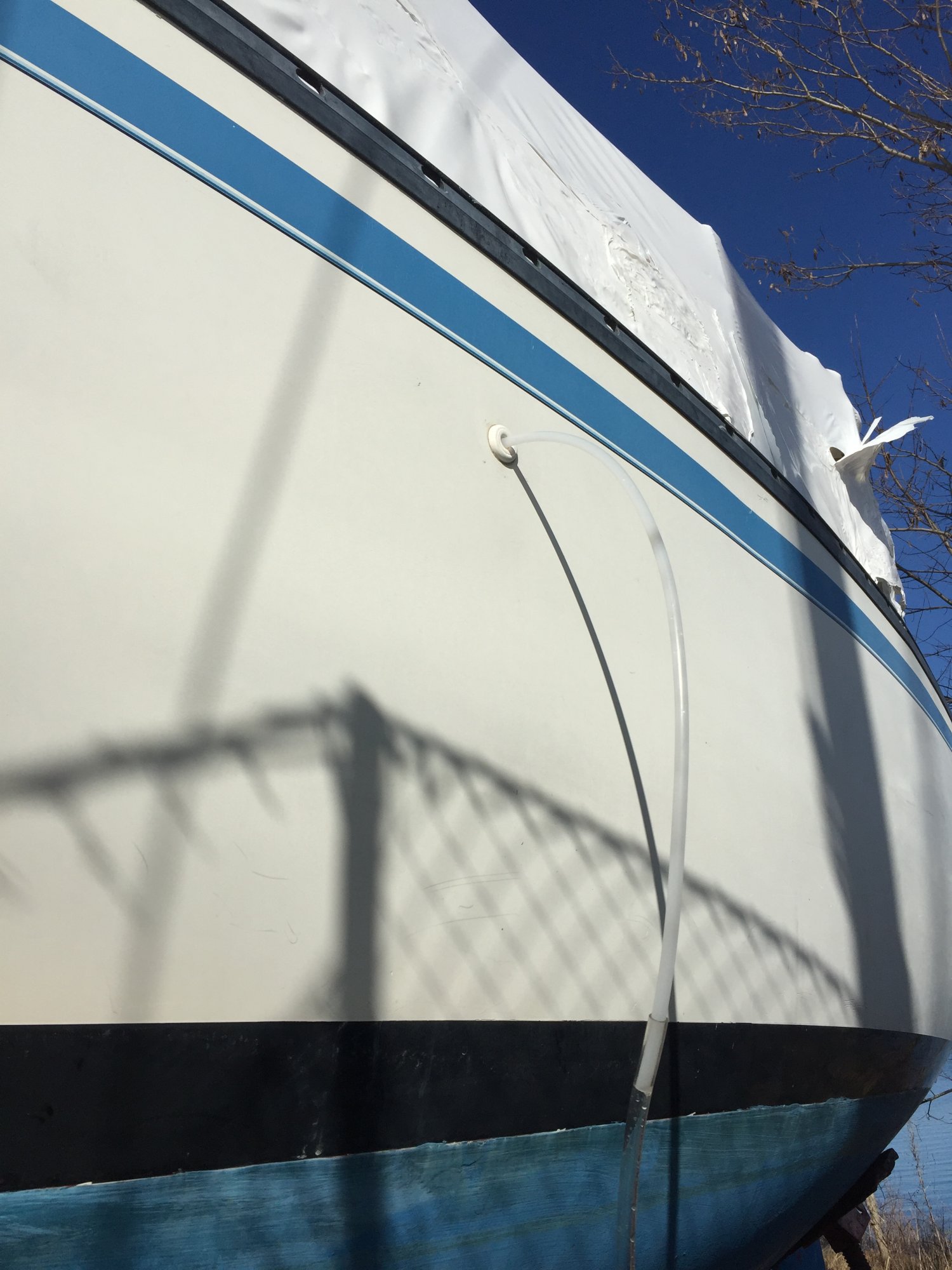

I leave a plastic hose in the bilge and a squeeze pump occasionally to empty any accumulated water.
