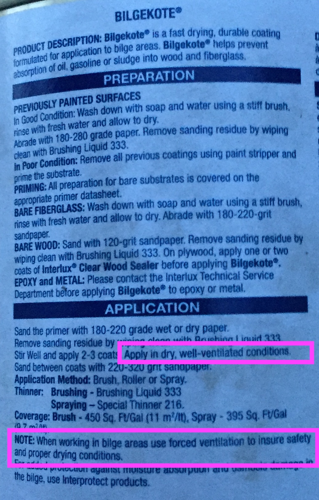

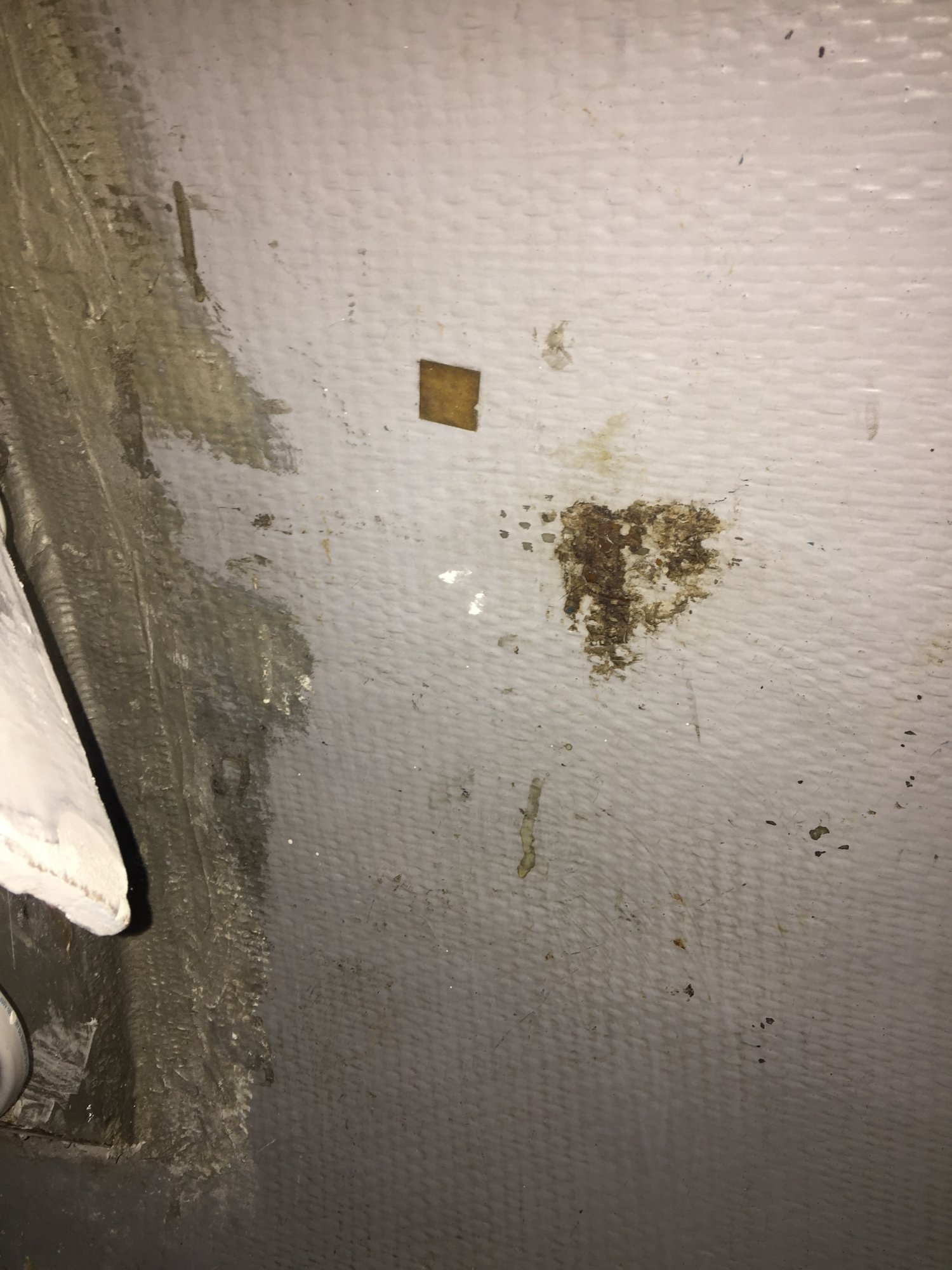

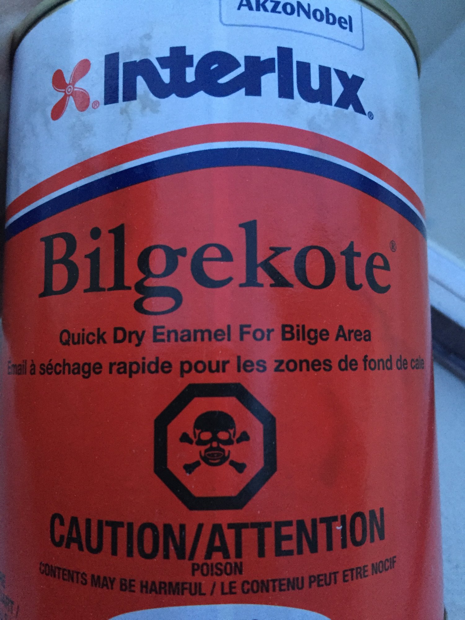

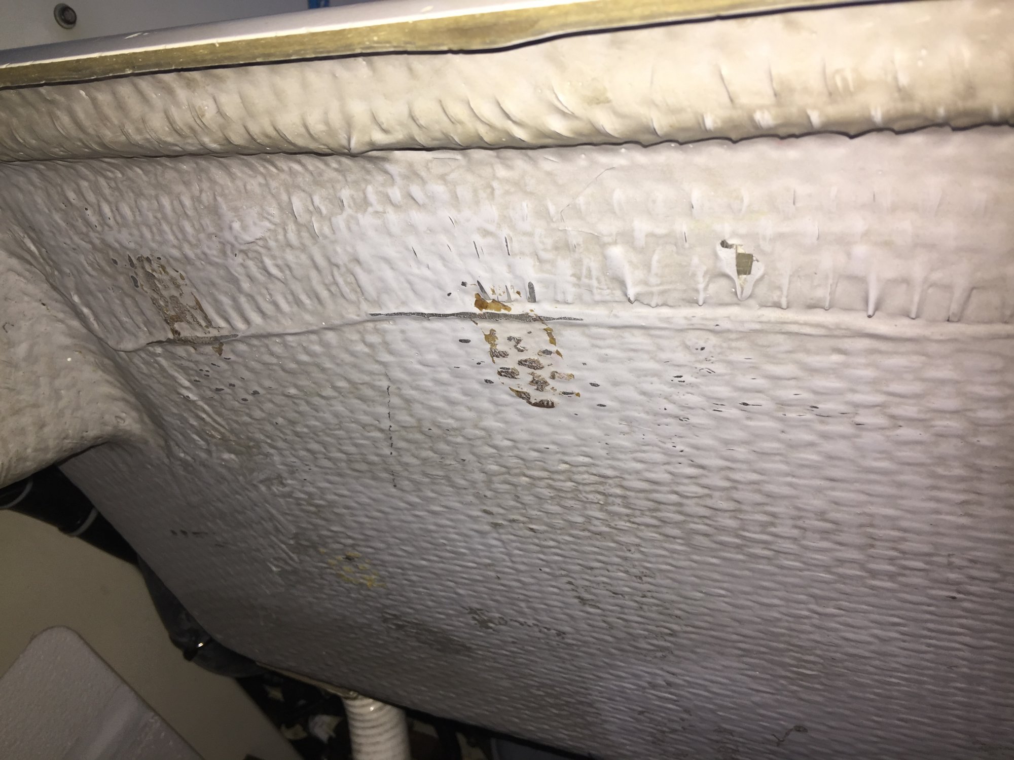

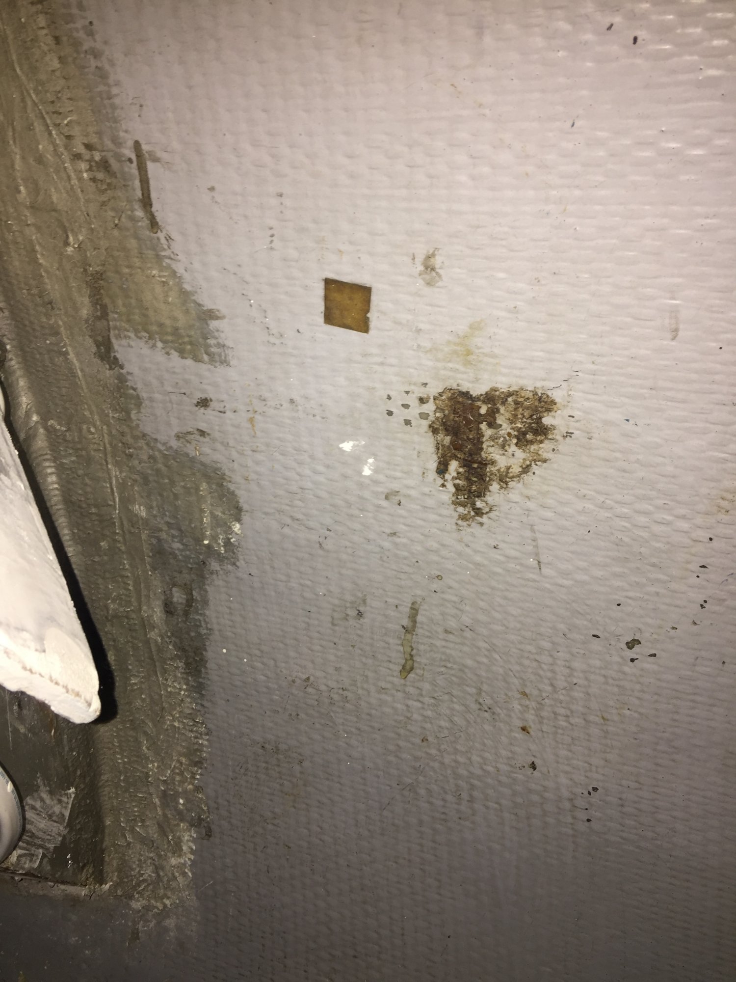

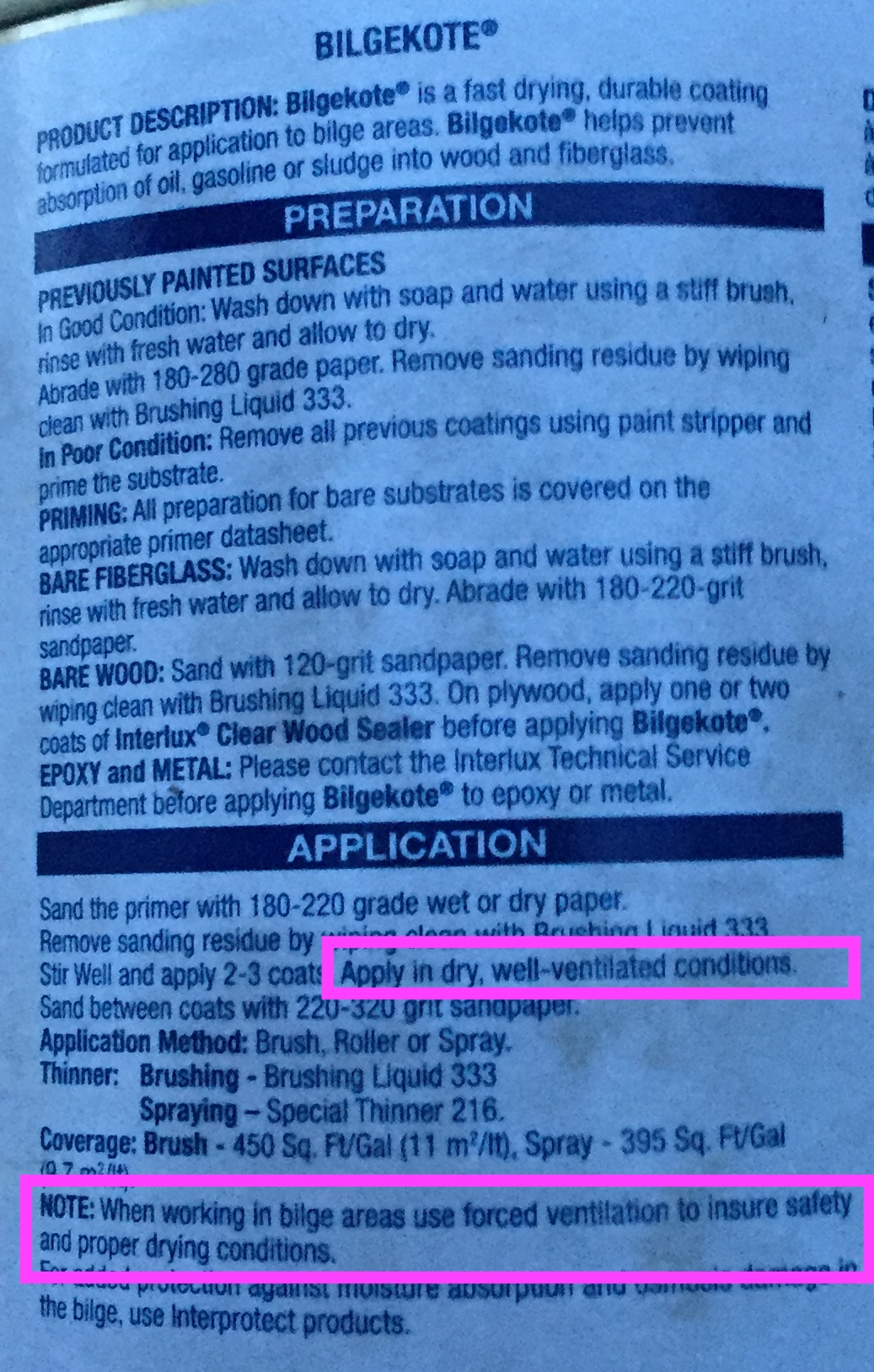

Im renovating inside my lazarettes under the cockpit. Any ideas on a bullet proof Bilge paint? The stuff by Interlux is horrible - really stinks the boat out with a strong solvent odour for months when ever I use it plus I don't fancy working in a confined space. It says on the tin to use forced ventialtion but wondering if there's a better solution. Thoughts?
