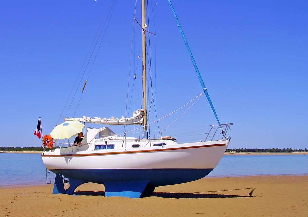

You all guessed wrong. The twin keel Hunter is a British built boat built by a different company called Hunter. When Hunter Marine set up shop in England, it was called Hunter Legend as the name of Hunter was already taken. Not sure of the tidal action in Britain but the twin keels sure does keep the boat upright

Hunter Legend may have built a twin keeled 22 footer, but the OP says his boat had a swing keel that was glassed over -- not the same. Going back to the swing keel would be the simplest option. Then if he still wants to beach the boat he could try to rig up crutches attached to the gunwales to hold her level. That might also require some engineering to handle the forces involved, but it can be done.

Hunter Marine and Hunter legend never built a twin keel boat. The two pictures show different configurations of side windows. I do question the OP claim. First start giving us a complete hull number in question and photos of the hull. Anything is possible but Warren Luhrs once said he would never build twin keel boats. Warren owned Hunter Marine in
The pics were not from the OP. They were from other posters suggesting what bilge keels and crutches look like on other boat models for comparison. Sounds like the OP’s boat is just an ordinary Hunter 22 with the swing keel “deleted”.

it would be a momentous job to put twin keels on a hull which is why I requested a hull number and pictures of the specific boat. @Darwinless needs to provide that as i question this. My dealership replaced damaged keels of various sizes and several with different keels which is very expensive. However the Hunter Marine and Hunter Legend I knew never built twin keel boats
