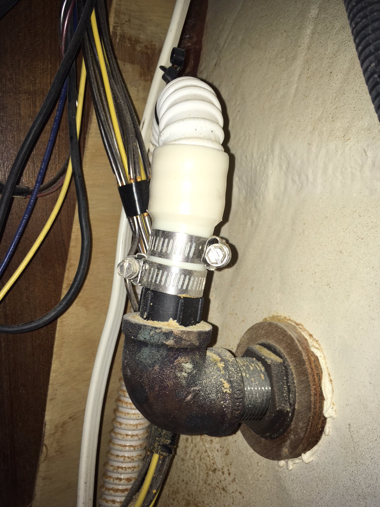

I bought my Hunter 356 new in 2003. Only recently did I figured out where the water in the bilge was coming from each time I went sailing. When healing, the bilge hose outlet at the side of the hull is under water & hence the leak - see picture
This is obviously an oversight by Hunter & would appreciate advice on how others have addressed the problem.

Absent some major plumbing changes, how about just putting a new (proper) hose with no cuff and leading the loop as far upward as you can. It's been 14 years and those inexpensive old hoses are 'bout due for replacement anyway.
The surveyors that I know frown severely on those old glued-on cuffs.
Part two of the answer: if your boat has a cheapie Rule centrifugal pump, escort it to a dumpster without even a proper funeral.
Replace it with a Jabsco 3-chamber pump, and the built-in check valves will not allow it to back flow even if water tries to come back toward the bilge.

In the unlikely event that your bilge pump started pumping during the bad side heel, you can face a significant back flow due to a siphon, when the pump shuts off [ high point loop or not].
The potential siphon would stop when the discharge point was returned to above water level.
A quick, but not fool proof, suggestion is to install a mechanically loaded [spring inside]...
Check Valve or reverse flow preventer in the pump discharge line
During a quick web search this is the concept using a hose barbed ends for a in line check valve.
https://www.industrialspec.com/shop/check-valves/plastic-check-valves/spring-loaded.html
Why did I say "not fool proof"? Even check valves require maintenance.;)

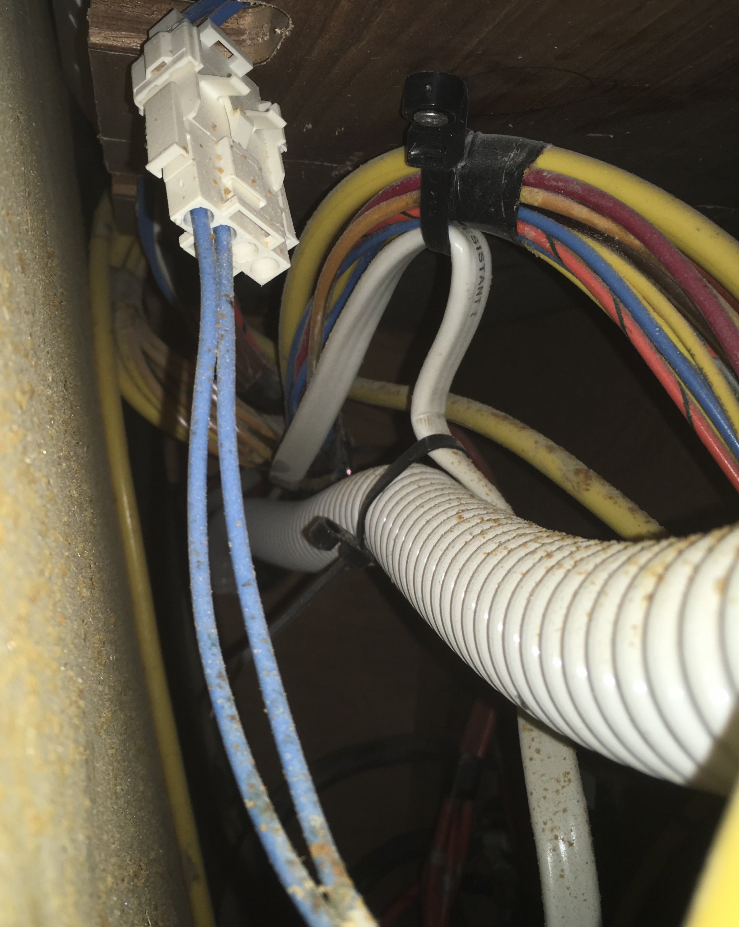

Thanks Jim, Although some people think its not a good idea to install a check valve, I have decided to install a new longer hose with a high loop going up near the deck. This is a difficult job as I encountered a wire tie (see picture) behind the internal cabin lining. I will then consider installing a check valve near the outlet. Later on, I think I will also install a bilge alarm.
