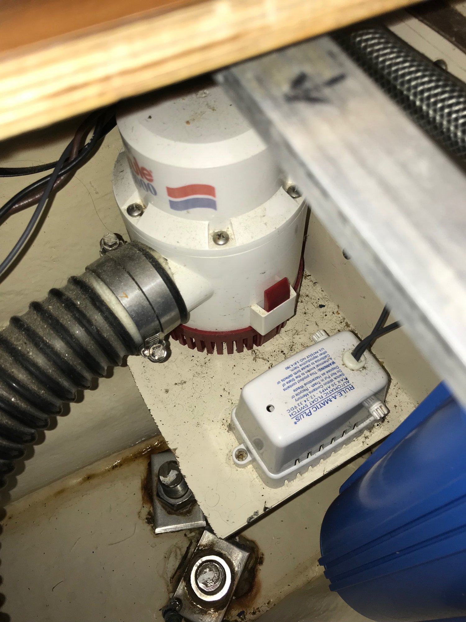

A second (high water) electric bilge pump can potentially facilitate dewatering if the boat partially fills after having been swamped or rolled. That is, it is not holed so no additional water may be entering, at least not rapidly. My second bilge pump, not yet fully installed, will kick in very quickly after the lower one goes off and the alarm sounds, if the water ingress is getting ahead of it. That is, the lower pump goes off. Next, a “high water” alarm quickly after if the water rises even a little more. Then, the second bilge pump, long before there is enough water to substantially fill the bilge, etc. Short an outright collision of some type, there are few places where water might enter via the hull. Diesel intake, or other thru hulls were a hose has broken off. If any are open, close ‘em. Inspect the rudder post; check the transducer & speed log thru hulls.
