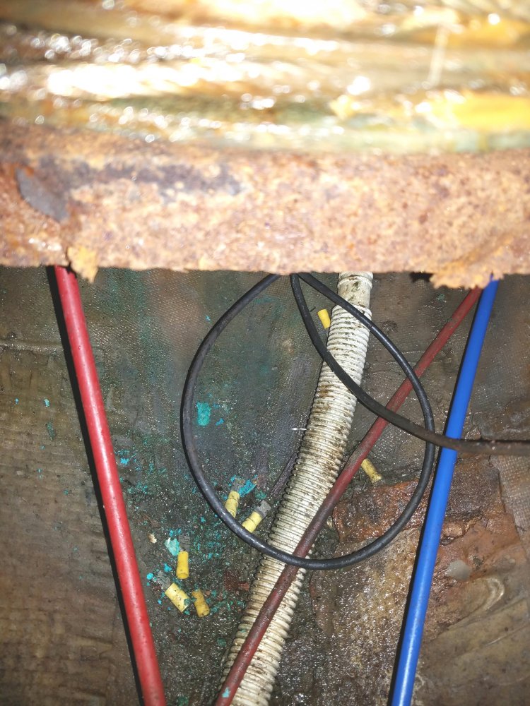

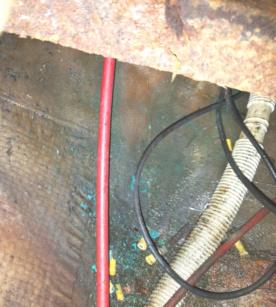

Hi everyone,
Now break it to me gently - new boat owner here and trying to fix up as much as I can to sell and get a bigger boat - our bilge fluctuates with H2O. We cleaned it with bilge cleaner and pumped it out but then noticed that a small amount of water ran to the bilge after the pump was shut off... An investigation lead me to climb behind the fuel tanks following the wetness... I found small amount of water around the helm components (don't know their actual name). See pictures for better description... My main question... What does this mean? How do I fix it? Or better yet, who do I ask to fix it?

A big welcome AmateurHour. You've come to the right place. There is bound to be someone with experience with your model boat. I can see the water tracks in the bilge grime, but it is hard to on know what you are showing. What kind of boat is this? I see you are from California. Southern or Northern? Could you have condensation from warm air and cold water? How fast is the water collecting? Is this seawater our freshwater (rainwater)?

AM: When the bilge pump turns off there is always going to be water in the hose which never makes it out of the boat. Naturally that flows back into the bilge. If you are seeing water near the steering gear then check out the gland for your rudder shaft. If loose that will allow water to enter the boat when under way. Or water could be leaking out of small holes in your bilge hose before it leaves the boat.

Now break it to me gently - new boat owner here and trying to fix up as much as I can to sell and get a bigger boat - our bilge fluctuates with H2O. We cleaned it with bilge cleaner and pumped it out but then noticed that a small amount of water ran to the bilge after the pump was shut off... An investigation lead me to climb behind the fuel tanks following the wetness... I found small amount of water around the helm components (don't know their actual name). See pictures for better description... My main question... What does this mean? How do I fix it? Or better yet, who do I ask to fix it?View attachment 152039 View attachment 152040
If you have an Ericson, register at ericsonyachts.org and put your question into the Maint. Forum. Lots of owners of similar models will be checking in.
(your bio seems to say that you have an Ericson 35)
