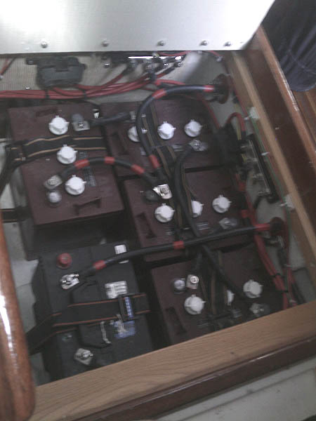

Has anyone actually put a set of six volt batteries in the bilge of a 37C? I want to install 4 Trojan 105's and a group 27 start battery. If so, any photos? (None on the photo or mods forums) Any help welcome. Particularly, latitudinal or longitudinal orientation? How many in which compartment? Shower sump moved forward?

made a 3d Model of group 31 battery out of pvc pipe. Got 3 group 31's in my SD bilge. Two athwart ships behind shower dump and one fore and aft in next compartment aft. Still working on space for 4th.

Thanks, guys. The L16's have much the same footprint as the 105's. The main difference is height. I feel better about buying them now. Any advantage to two L16's as opposed to two T-105's? Obviously cost and weight, but in terms of power, longevity etc.?

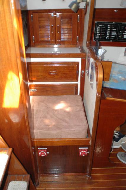

I have 2 290-series deep cycles in my bilge ( deep draft ) on shelfs built by the PO. I was going to move my shower sump and make room for a 3rd just behind the mast, but my wife suggested I put it in the starboard storage under the couch. I think thats an excellent idea, and would actually hold 2 batteries. I also think that side of the boat is light, compared to the port side which has a full-length water tank and the diesel tank. Should even it up.
Once its done I will have 4 290's for the house bank, which should give me about 420-440 amp hours. How many amp-hrs will you get out of those LT16 6 volt batteries?
I'm also curious if other 37c owners use that space for batteries. There is already a hole from it going into the bilge for the water pipes, so it seems a good idea.

Got the Trojans today so tomorrow is glassing in the shelves etc. for them. Will send photos later.
