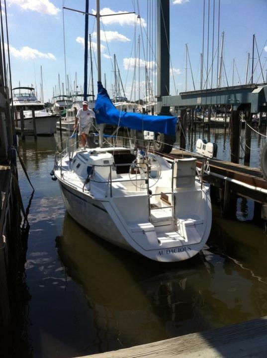

The stern is a walk thru, no rail seats. I have put one bike ok the steps, but yes, it makes it tough to get into the dink with just one there.
Looking at the car trunk type racks, I may be able to make that work with the two rails at the stern, off to one side. If it were adjustable enough, maybe the wheels wouldn't ge dunked on a heel. I have no idea how I'd make the tow hitch type work.

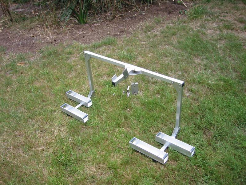

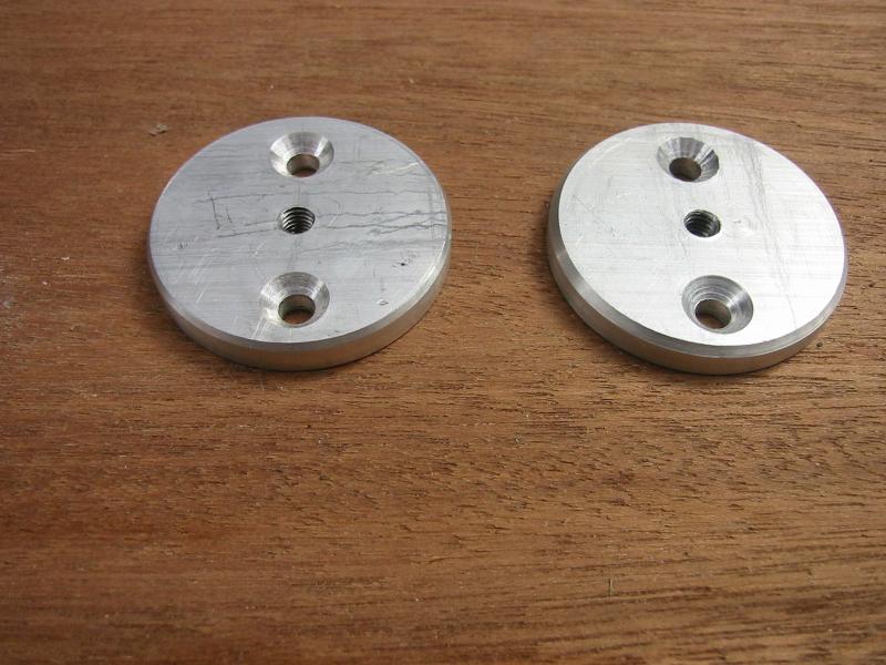

My Solution
Not exactly for mountain bikes but it takes a couple of folders (not folded).
The rack simply attaches to two 2" diameter alum disks I screwed to the transom using a couple of wing bolts. The bikes are retained by a wing bolt through a pedal on each bike and into the central bracket. They are quick to get on and off.
The rack is all alum and can hang on the garage wall when not in use complete with bikes.
The rack folds and, together with bikes, goes into my Lexus trunk.
The bikes can stay on the transom all season if necessary as they don't seem to get salt spray.
