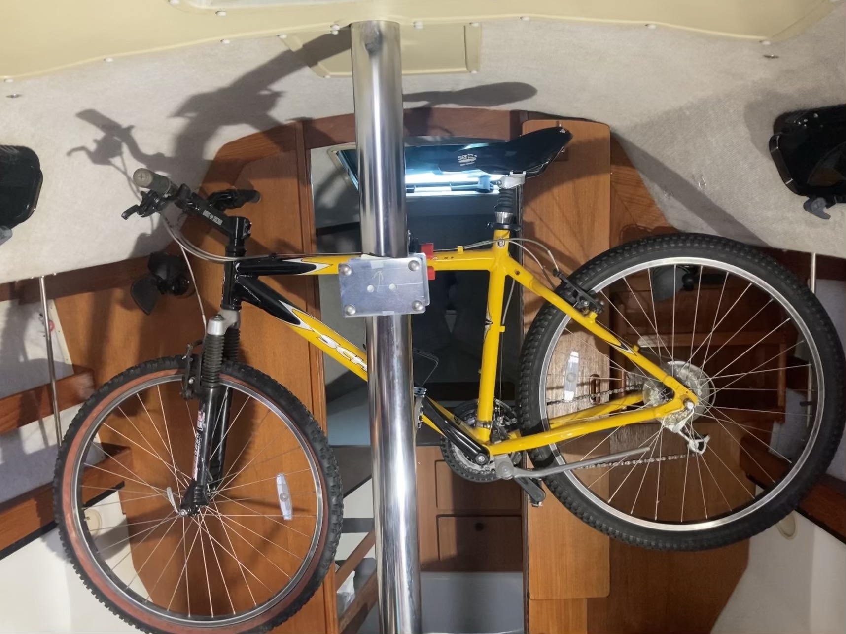

I am sure someone has done this before but thought I would share. Since I have not tested yet open to opinion.

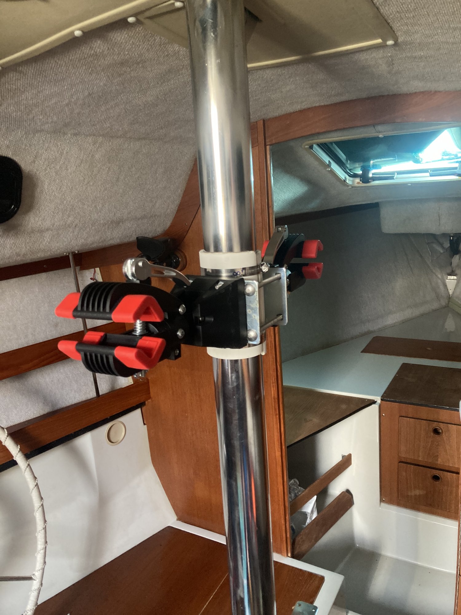

Ordered a bike clamp off Amazon attached it to stainless plate. Riveted the plate to a schedule 40 PVC. Clamped it to the mast post using hose clamps. Installed one forward and aft up post. I did reduce the arm of the clamp so it is close to the post void swaying. The clamps are pinned so they can be removed when not using.

Clever. But I would sure hate to bang into that bike on my way to the head in a heavy sea. Sometimes it’s hard enough to stand, much less dodge bikes. But, a nice way to transport a bike with you.

Clever! I wonder if you could turn the bracket 90 degrees so the bike sits fore/aft and would be a little more out of the way?

Yes, you can turn the any direction, I added a third on standard side. That one sits under the other two with the wheels of the bike on the cabin deck. The clamp holds the bike in place so it can’t shift around.
The only thing forward on the Oday 302 is the forward berth. You can get to the head without a problem and galley just fine.

In seeing the idea, it would be interesting to see if the bike would lay flat against the ceiling. Might even be able to mount the clamp to the ceiling so you can clamp to a more central balance point.
