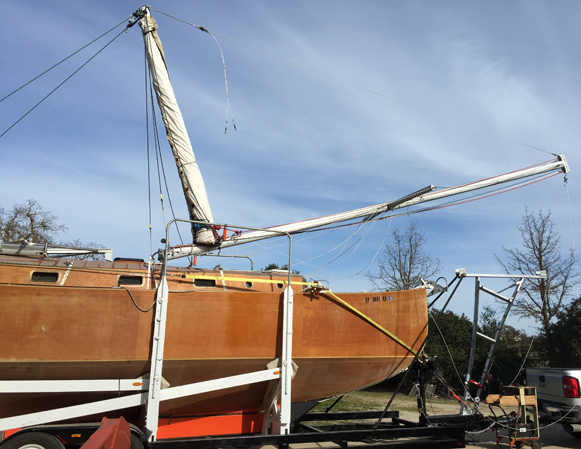

Picture #1 LuLu in erectus

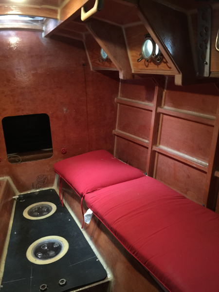

Picture #2 Interior shot from cockpit looking forward

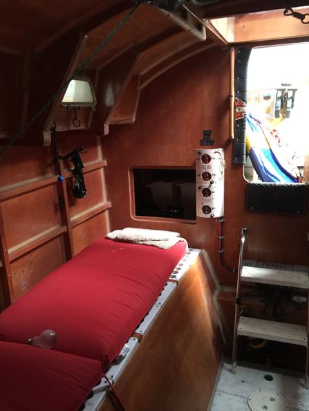

Picture #3 Interior of Aft Cabin shot from hatchway steps looking forward

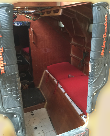

Picture #4 Interior of Aft Cabin shot from mid bulkhead looking aft

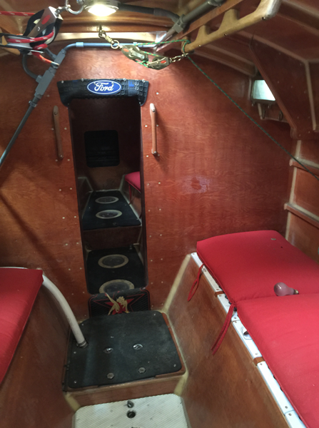

Picture #5 Interior of Forward Cabin shot from mid bulkhead looking forward

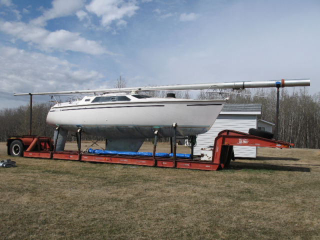

Tartan 37 with the swing keel. Production offshore-capable boat that has a pedigree of winning offshore races. A big boat that is just barely trailer-able (limited by launch ramp angle and length).
12,776
Hmmm... might have to call that one out of bounds...
Awesome boat.... I once dated a girl who's dad had one of these... we sailed to Mackinak Island one weekend.... it was grand... but the Tartan 37 has an 11'9" beam. I think the accepted max beam for a trailerable is 10' and even then many states require a limited wide load permit.
