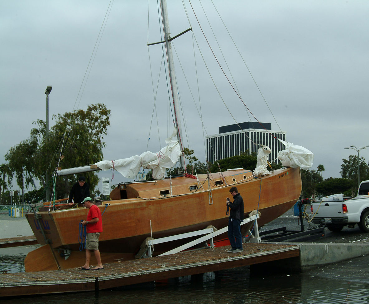

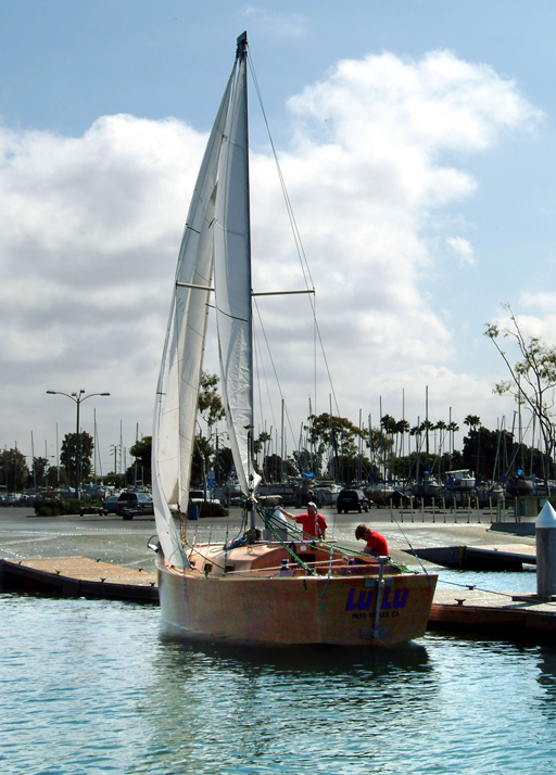

Thanks to all of you for taking time to reply to my original posting. I didn't and don't really care whether LuLu is "biggest, ... ". But I do care to hear experiences and ideas from any smart, interested folk on the subject of large scale water ballasted trailer sailers. Here a couple of old pics (all I could find at this moment that would paste direct). I'll add more recent ones (when I figure out how to correctly attach them here), and answer questions, in a longer posting to follow soon.

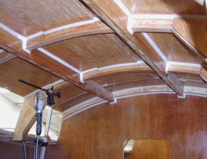

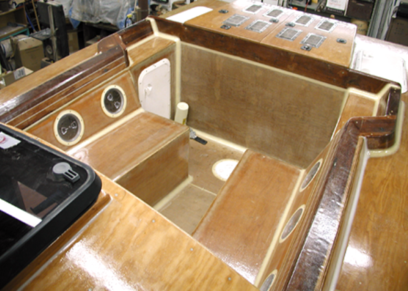

To Druid. Here are two pictures indicative of LuLu's interior works. Very old ones (2006!), but all I could find this morning.
Please hold your interest in her interior; I'll post some current pictures as soon as I can get them taken.
Incidentally, my comment to Jackdaw about LL's stitch-and-glue construction was incomplete. I should've said "Not stitch and glue per se: rather 3/4" planks bent over bulkheads on strongback, then super large ... etc."

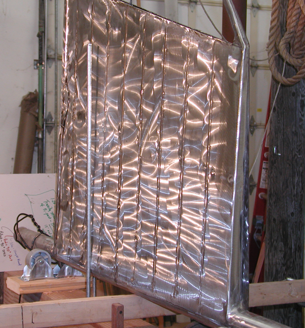

To Windtherapy. LuLu's rudder was a proud boat building achievement for me, I admit. Here's a picture during construction showing its inner structure of bent stainless steel ribs, stacked vertically, welded horizontally and to the post, to be covered next by 3/8" plywood cheeks. Very strong, but also probably a little heavier than it needed to be (200+ lbs).
