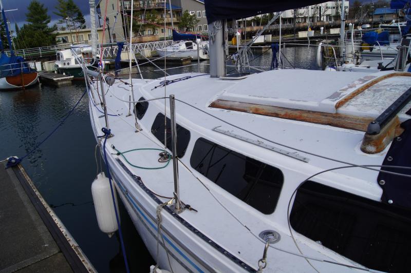

looking good....Ive got some 10% film for mine. just waiting on warmer weather to apply when I reseat the windows.

Nice looking, Parent.

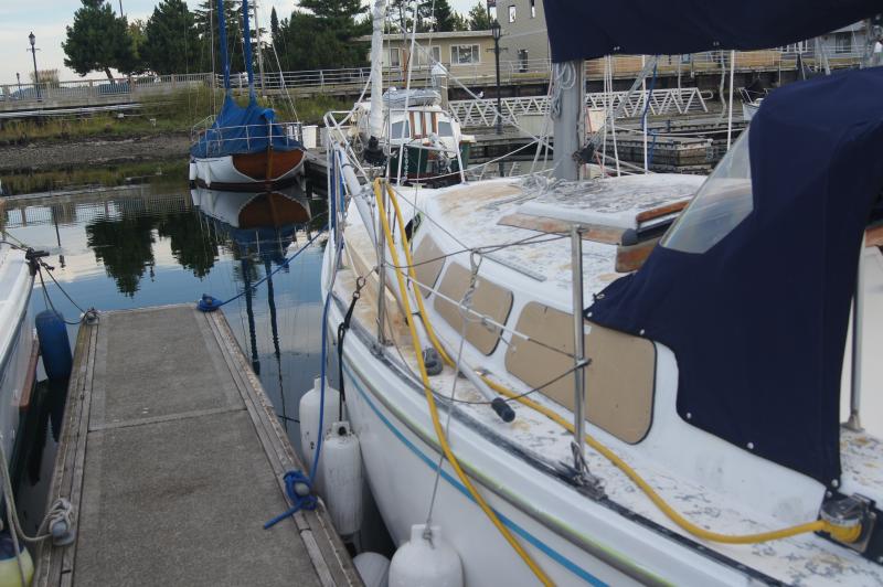

I'm looking at launching into the same job next fall and you seem to have the same frameless windows I have.
Can you describe how you removed the original plexi ?
When I look at some of the large, adhesed landing areas under my windows, I"m considering using either a jack hammer or thermite to remove them.

These windows replaced the old aluminium framed windows that now take up a corner of my garage but my suggestion is to get a piece of wire that is made for cutting the glue ...get it from a glass shop ..they cut windshields out with it

.................... if the jackhammer doesn't work, I'm looking at using the finest piano wire I can find for cutting the original 795.
