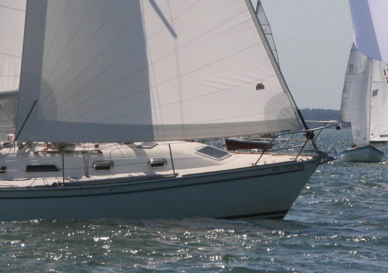

My used Tartan 3800 came with high-tech, racing sails: film-on-film mylar/carbon fiber. The jib is huge, a deck-sweeper, and there's no luff pad, so it doesn't reef well. The Harken furler's drum is low, and the anchor shank hits it when we drop and weigh anchor. I will be buying new sails in the Fall and I want to raise the furler drum and order a smaller job that's not quite a deck sweeper.

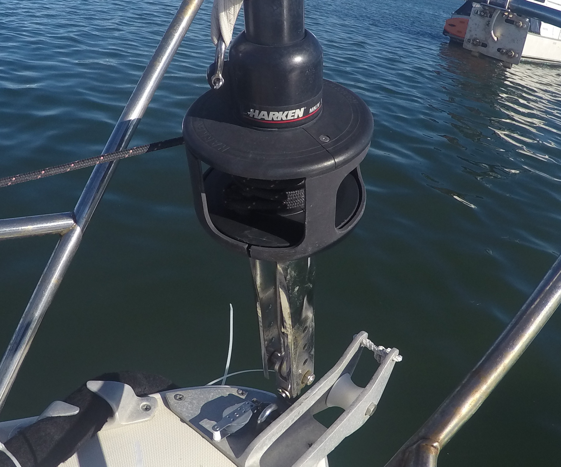

Here's picture of the extension below my Harken unit, which raises the drum enough for the shank of an anchor ro be raised. The end result is a sail cut above the deck, which is quite a plus in terms of keeping a lookout.
