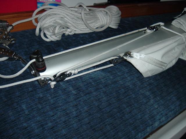

What I did...
Here's a picture of what I did. I had several inches at the end of the boom though where you may not.

Just saw Jerry's, which is even better ... his would be 4:1 with the block at the clew.
