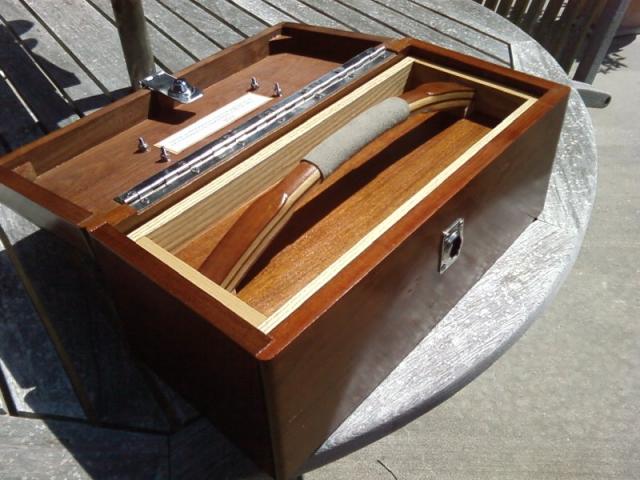

I am a fan of IPE wood, but it is not light. It would have to be dowelled as your picture to get one piece.. may not be an option, but if ya brought the materials and dimensions to a cabinet shop it probably could be fabbed for not too much. Attached picture is of a tool box (tung oil rub finish) made of IPE .. You can see the raw wood inside the opened cover. Probably more tough and rot resistant than teak.
