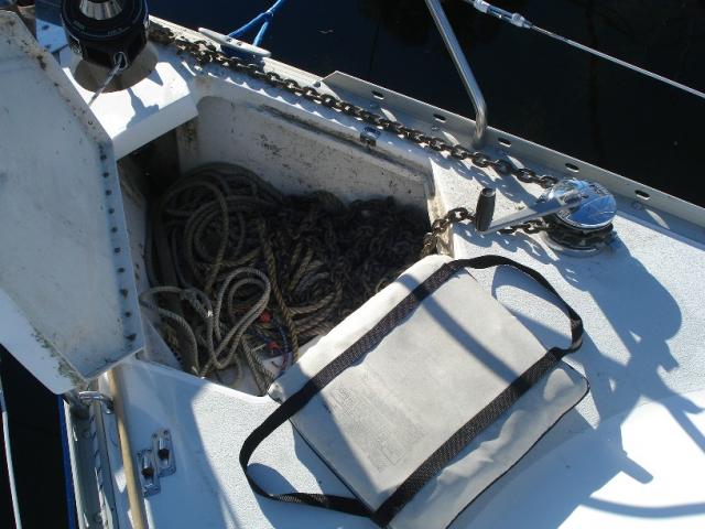

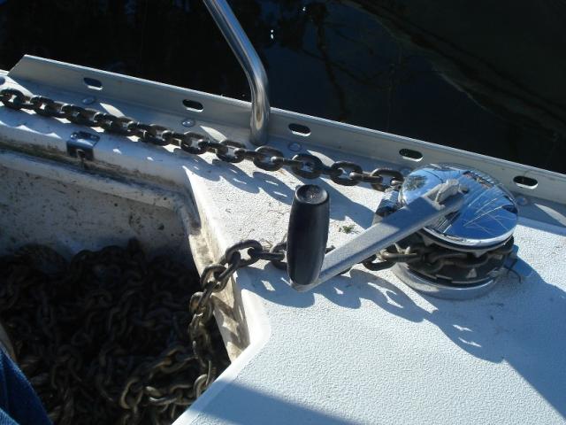

Sorry, I haven't checked the forum in awhile. I've attached a pic of my windlass. It is a manual Lewmar windlass. I'm pretty sure they do not market this model any more. (I got it half price from West Marine.)
I wind it around with a shortish winch handle. I sit with my feet in the anchor well and kind of help the rope and chain into the locker as it tends to pile up. This works fine for me.
For installation it was necessary to gauge out the deck core and fill with epoxy and of course add a sturdy backing plate underneath.
I can send more pics, if anybody wants to see them.

I sit on the cushion with my feet in the well.
