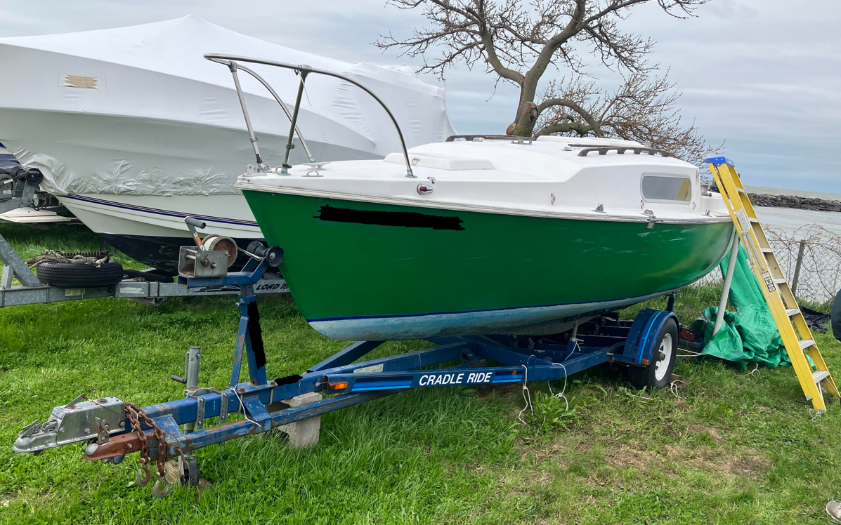

A friend and I bought our first sailboat! It is a Morgan 22 (similar to Catalina 22). We need to transport the boat to our home Marina which is about 25 miles by water (Lake Erie) or by road. And we can't decide on the best way to transport it. Let me briefly go over the state of the boat, motor, and trailer. Photos at the bottom.
The Boat
1969 Morgan 22, 2700 pounds. Was used just last season so should be seaworthy. It is currently in barebones off season storage configuration sitting on the trailer. It does have the motor mounted on the back.
The Motor

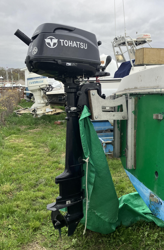

2018 Tohatsu SailPro 6 hp, 25" longshaft. Looks great and runs great according to the previous owner.
The Trailer

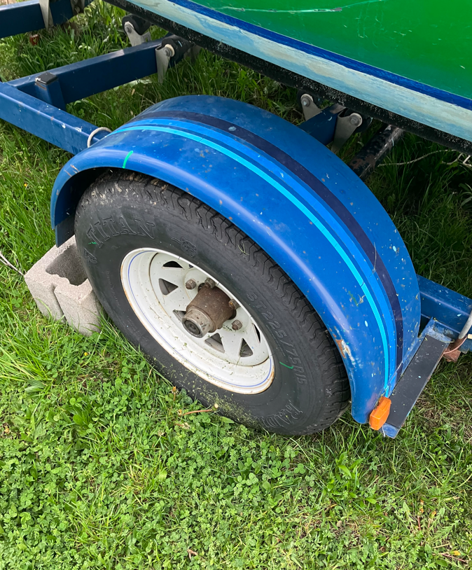

Built in 2005. Frame looks to be in good condition. Single axle, it hasn't had tires or bearings in 10 years, tires look pretty dry rotted, hard to tell bearings while it is sitting there. Trailer hasn't left marina in 10 years. Previous owner says he does grease the bearings occasionally. He does not think it's roadworthy and has warned us against trailering it as is.
The way I see it we have 3 options. Neither of us have much experience with boats or trailering them so I am curious if there is a obvious choice from the community here.
1. Launch it at the marina it's currently at and motor it ~25 miles. We will set up the rigging at our home marina so this trip would be all motor.
2. Drive the trailer and boat as is. Maybe stay off highways..
3. Try to fix the trailer, at least throw some new tires on. and then drive it. The issue here is the boat is on the trailer and we don't have any place to put it while we work on the trailer. Working on the trailer while the boat is on it seems sketchy to me.
What would you do?

Changing the tire while the boat is on the trailer is not a big deal. Block the wheels, loosen the lug nuts, jack up the trailer and swap the wheels. The photos show the trailer to be pretty rust free and it is light enough that brakes should not be an issue.

I would not take the trailer down the road in it's current condition.
With about 8 short pieces of 2x10 pine (15" long or so each), a bottle jack, and a pair of floor stand/jacks (because you never trust hydraulics), you'll be able to easily jack the trailer up and remove the wheels. Take them somewhere and have new tires installed. Then, reinstall them on the trailer.
Now, if you are within just a few miles of a shop that can perform additional repairs to the trailer, take it there.
- It looks like you have surge brakes on your trailer, and they're probably in need of repair. Many hundreds of dollars, and probably under a thousand dollars, depending on the condition.
-Get new bearings. Don't rely on the bearing buddy zerk and simply add grease. Get new bearings. They're not that expensive.
-Of course, make sure your trailer lights are functioning.
- A good 2" nylon ratcheting strap is around $32.00. Get one to hold the stern to the trailer.
- Your bow eye attaches to the trailer winch, but it's a good idea to use a piece of rope to tie a secondary to a bow cleat.
- You need a tow vehicle that's capable of towing it safely. Pretty much ignore the figures the vehicle manufacturer gives for towing. You want to know PAYLOAD. Figure the weight of your boat and the trailer, and multiply by 13%, and that's the likely weight of your trailer tongue. That is only ballpark. Big ballpark. That's the weight that's going on the bumper, and unlike a travel trailer, your trailer has no weight distribution springs. All that weight is going on the rearmost portion of the vehicle. The math has to be very much in your favor. An F-150 will likely be a bit marginal. I'd want an F250. Too much weight on the back bumper, even if you're within the limits of the math, and you will be pogo-sticking down the road as you go over small bumps and dips.
I can't advocate shortcuts. Not only could you find yourself disabled by the side of the road, you could be involved in an accident. With injuries? When the other guy's attorney discovers that the brakes on your trailer were not functioning, it would be much better to be the other guy...not you.
You'll easily drop a grand or more into your trailer.
From your post, I get the impression you don't plan to regularly trailer the boat, and your repairs may be for a one time use? In that case, it probably makes a lot of sense to launch where your are, and motor the boat to where you want to be, so you can tow the empty trailer where you want it. I'd still put new tires on it. It's not hard to do. Run you a couple hundred or so. You'll still be yanking a brake-less trailer down the road. I'd to it at midnight. Lights working, or course. And do not skimp on the tow vehicle. The Subaru ain't gonna cut it. F-150 is minimum.

There is lots of good trailing information in this post. However, I doubt the trailer has surge brakes, brakes are required based on trailer weight. This is a light weight trailer and the boat is well under 3K pounds. I believe the weight requirement for Ohio is 2000 lbs. I weighed a similar trailer on a truck stop scales once and it wouldn't even register.
Buy the tires mounted on wheels ahead of time and bring them with you. Here's an Amazon link for tires your size. Jack one side, replace the tire and wheel, then do the other side.
Replacing the bearing is your call, however the trip is 25 miles and at lower speeds on back roads the risk is lower. Do replace them once you get home, especially if you intend to trailer the boat in the future.
Do secure the boat to the trailer, ratchet straps work well and can bet tighter than any amount of rope and knots.
Get it home, clean it up and go sailing!

That big lump on the trailer's tongue. I'm figuring it's either surge brakes or a mailbox. Leaning toward surge brakes. Trailer and boat are creeping up on 4000 pounds. In an emergency stop, you're stopping the equivalent of two vehicles.
Up to the OP how many shortcuts he wants to take.

The trailer looks to be in good shape. Have a good look at the tires and decide if you want to replace them. They are pretty cheap if you do it yourself, but quite expensive to have someone else replace them. Can you tow the boat around the block for a couple miles on back roads? If the hubs stay cool, and you are OK with the tires, then I'd be tempted to tow it 25 miles. You are not me though, so you might prefer to follow @Siamese sound advice and be more assuredly safe.

First of all, as seen in the photos, the trailer has surge brakes. Whether they work or not, is another thing. Depending on your tow vehicle, you probably can make it 25 miles with no brakes, but that is up to you. Obviously if you are pulled over by a cop and he/she checks the brakes (very unlikely), then you will be forced to fix. If your tow vehicle is barely big enough to do the job, then that is a problem in itself, brakes or no brakes.
Looking at the photo, the trailer looks to be in pretty good condition strength-wise. Of course I am not inspecting it in person, but it obviously is much newer than the boat.
Regarding tires, if it has enough tread, and no sidewall cracks from sitting in the sunlight, and they hold air, I think they are just fine. If not, then replace them. That is not a big deal.
Regarding bearings, zirc fittings sticking out from Bearing Buddies are an easy way to add grease, but they don't really address the inner bearings. If the wheel, doesn't move back and forth and seems tight, then you are probably good for 25 miles. if you feel play, thenI would pull the wheel and the hub and just look at the bearings inside (there will be two - inners and outers). If they look good, then pack them with grease and put it back together and then you will feel comfortable about not worrying about them. You might damage the outer seal taking them apart, so you get the number off the seal, go to a place that sells bearings and buy two more for each side. If the bearings are visibly shot, then get the number off the bearings and races and buy new and put it all back together after packing them with grease.
