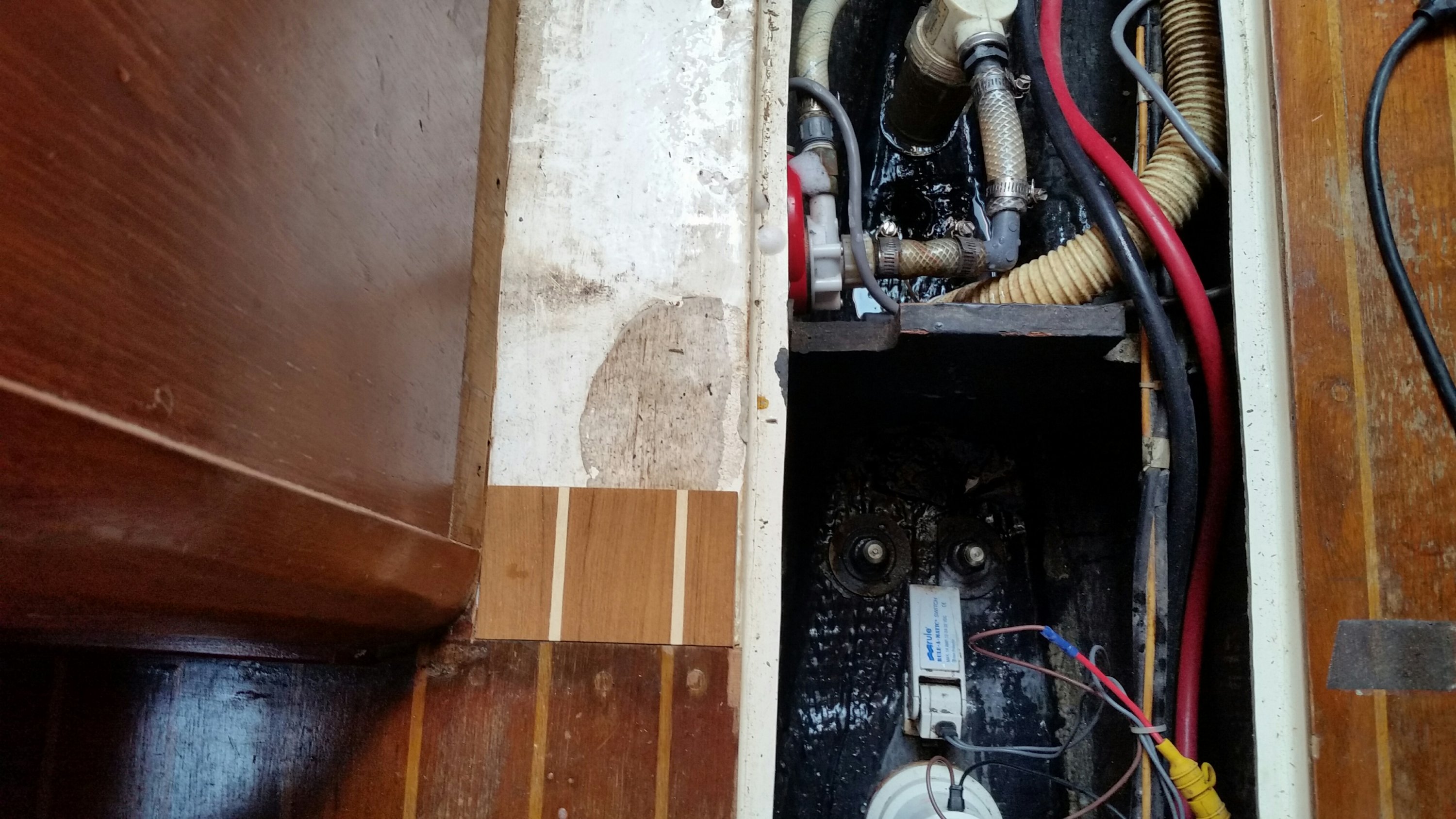

We are in the process of doing ours bit by bit. Her is an example of what it looked like
My son used these tools for his work Porter Cable random orbital palm sander, and Harbor Freight (Fein type machine)
The holly had already been sanded through in spots by a previous owners repairs
The little Harbor Freight (Fein type machine) actually worked quite well.
Ready for Varnish (notice the missing holly stripes on the ends
After 3 coats of varnish. Not perfect, but a lot better than before.

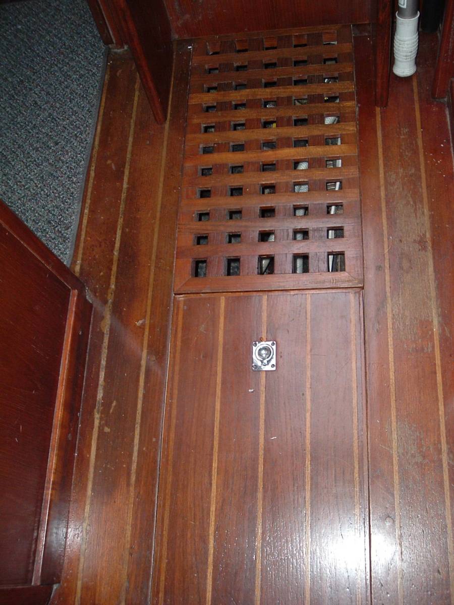

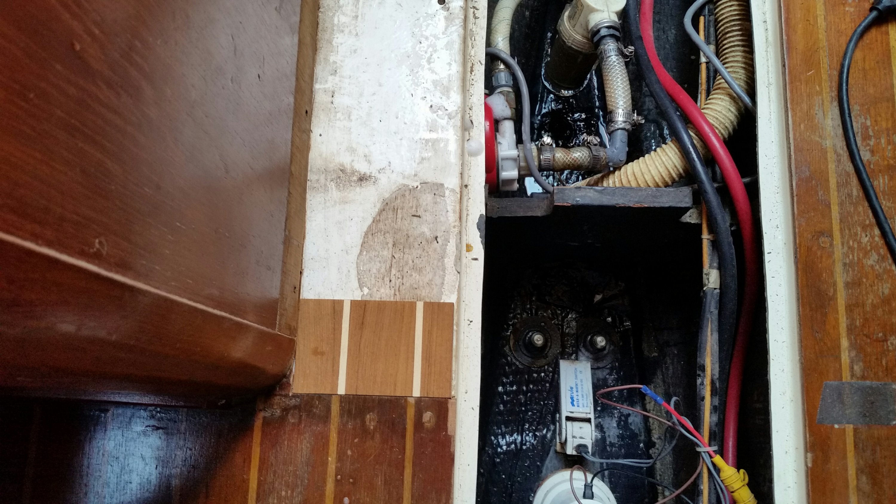

You can see from this photo maybe why I don't think I need to remove the varnish. There is a very worn spot to the right of the ladder. I thought some sanding and a little stain before the varnish would be satisfactory. The second photo shows where I am installing new flooring.Bilge1.JPG Cabin.Sole2.jpg
