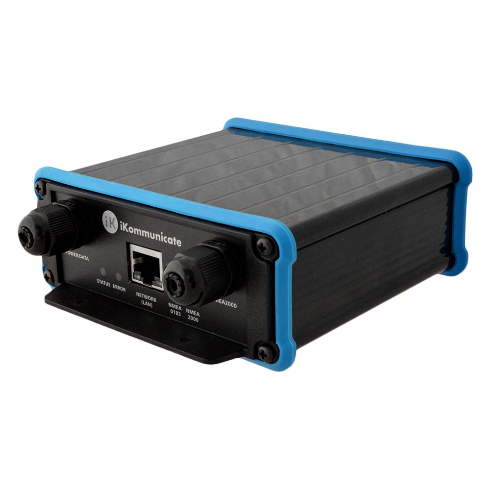

I’m not sure if your instruments are using the old Seatalk format or Seatalk(ng) I had an old Garmin mfd that did not provide a wireless connection. Through a kickstarter campaign with Digital Yachts I bought an Ikommunicate, connected to an old home WiFi router. The router puts out the “signal K” format that interprets NMEA 2000 and 0183 data and then a number of cheap or free apps access the signalK information and display the NMEA data in your apps. Here is a link to a unit, plus you can go to Digital Yacht to read more about it. It sounds more complicated than it really is, if a dolt like me can set this up anyone with reasonable DYI skills can.
