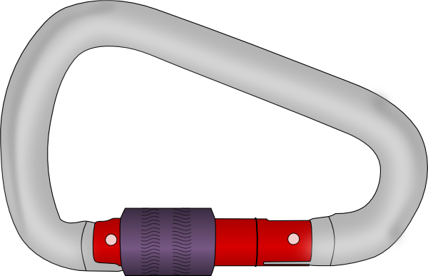

I've done something similar when I run a sheet to tiller self steering... but I ran it to the hand rails. I found a large carabiner clip worked very well for this purpose. I clipped the block to the the rail using one like this
But I think you could also use a strong piece of nylon line and simply tie it.
