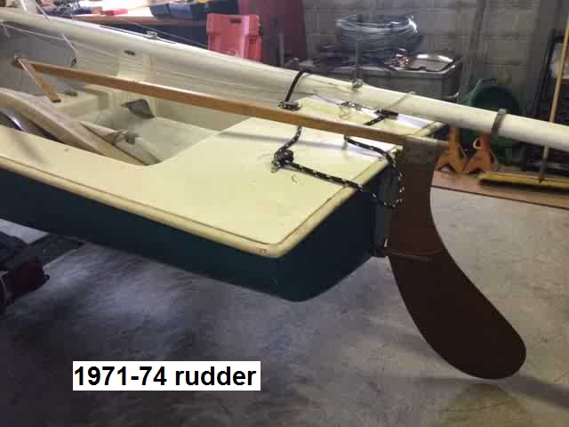

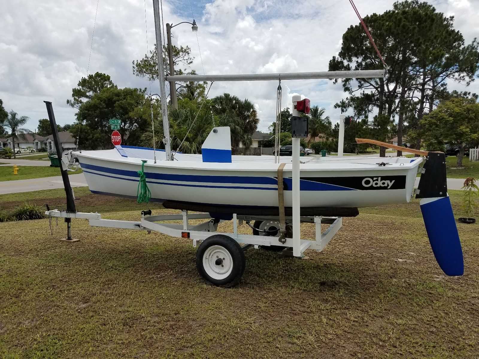

Here are the 2 different O'DAY 15 models:

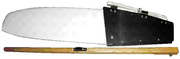

And the different rudder designs each had:
