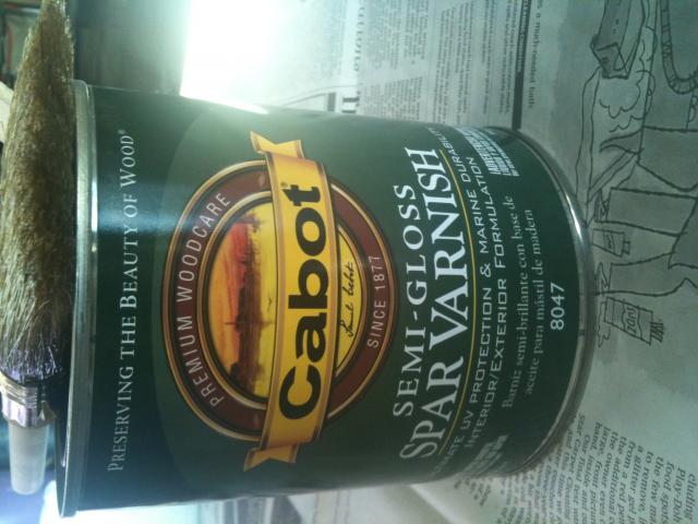

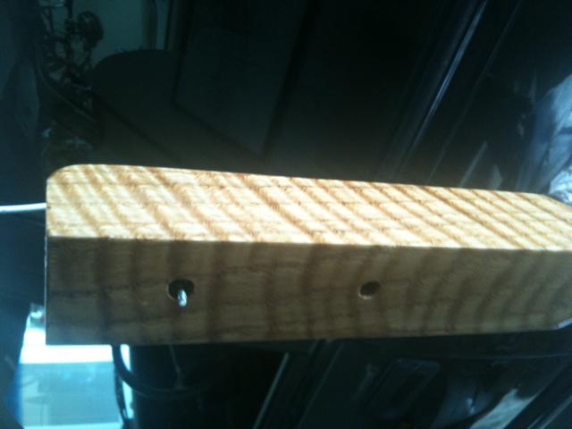

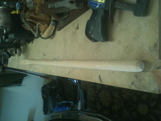

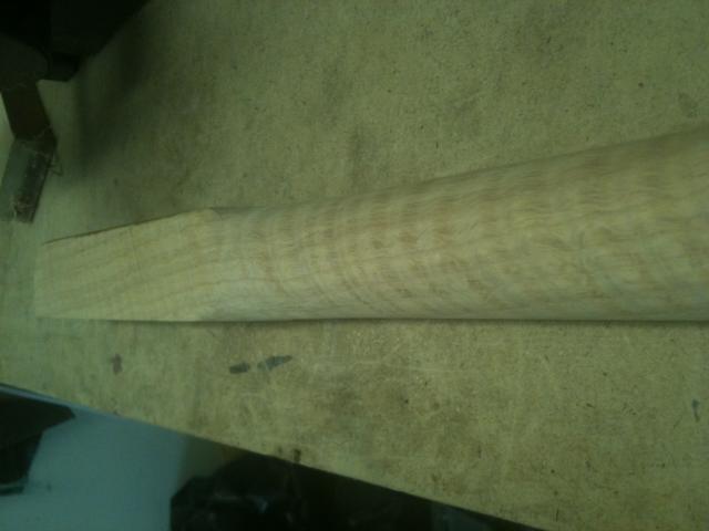

Ok, I got ants in my pants. Here are some pics of my progress. I bought the Cabot because of the UV rating and Marine Durability designation. I'll put a cover on it and try something different next time if this doesn't work well. The varnish really brings the figure out in the wood. Thanks again for the input.
