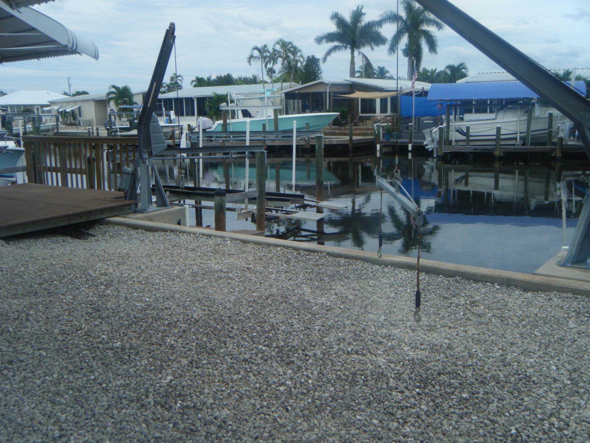

It doesn't have D ring lifting points so Im thinking large 3 inch wide heavy duty loop straps hooked to my 6ft wide steel bridal bars
could lift it. Also have a tag line going to the bow and the stern to keep it centered and just lift if up and could swing it around
and sit it on a cradle of Foam blocks in this gravel area I have. The boats weight is only around 500 pounds. The mast are freestanding and I can just pull them out

Im going to figure this thing out some way. So I can use the Davits for the sailboat and use the boat lift for
a outboard motor boat etc.

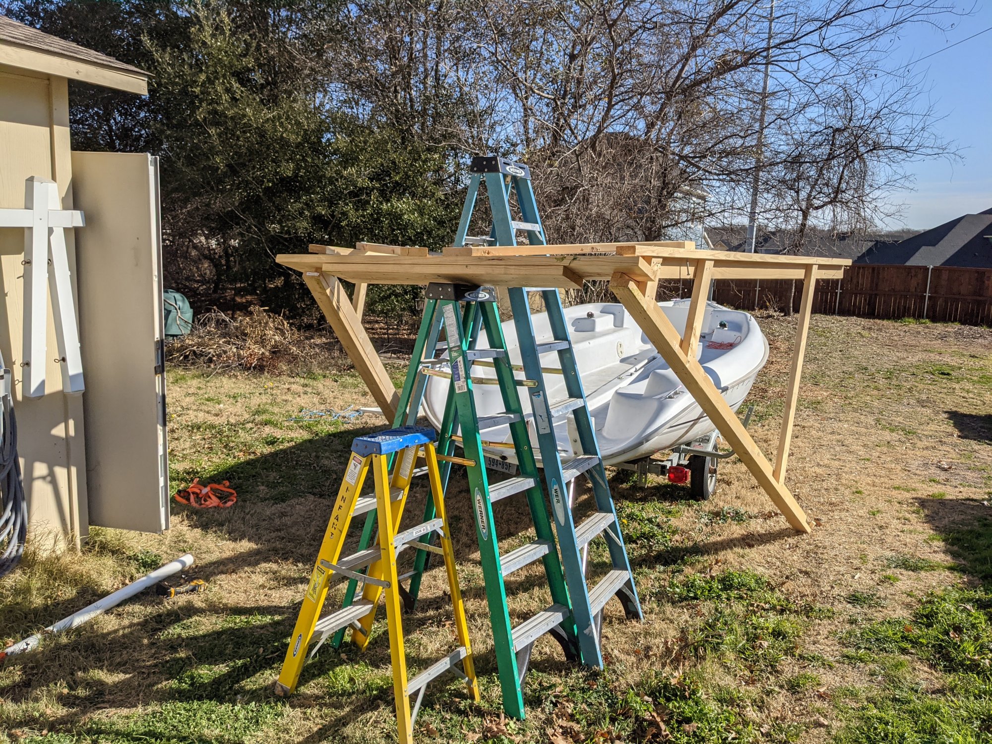

I constructed a truss (more like an oversized sawhorse, actually) to lift my 170 off the trailer. Legs are 2"x4"x10' white pine nailed together to form an "L". Top crosspiece is constructed from 2 2"x10" yellow pine boards. Note cross-braces on top running from crosspiece to legs. I used a lot of framing braces and lag bolts to allow disassembly. It's hard to tell from the photo, but the legs on either side of the upright angle toward the crosspiece (like you would see with most sawhorses) to provide extra stability. I used heavy-duty 3" towing straps (NOT like the orange one in the photo), looped around the hull well fore and aft of the centerboard and looped through the hook on a cable hoist to lift the boat free of the trailer. Cable hoist was hooked over a 5/8" bolt passed through the 2x10 top crosspiece at a downward angle. Sorry, no photos of that. I stood in the boat while hoisting, but I am only 150 lbs, to total weight was about 750 lbs. You will definitely want a control line to prevent rotation.

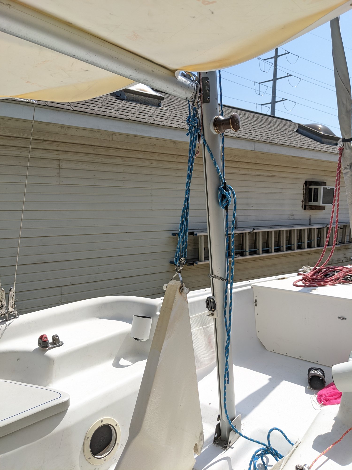

I would recommend removing the centerboard before lifting the boat free of the trailer. It's about 85 lbs. I used the centerboard control line block and tackle to help in the removal and installation process (see photo). Hopefully your trailer will allow this. Otherwise, do not trust my rig or any such hoist to support the boat while you are under it.

Photo shows the three-ladder arrangement I used to get the truss upright. It's a bit heavy.

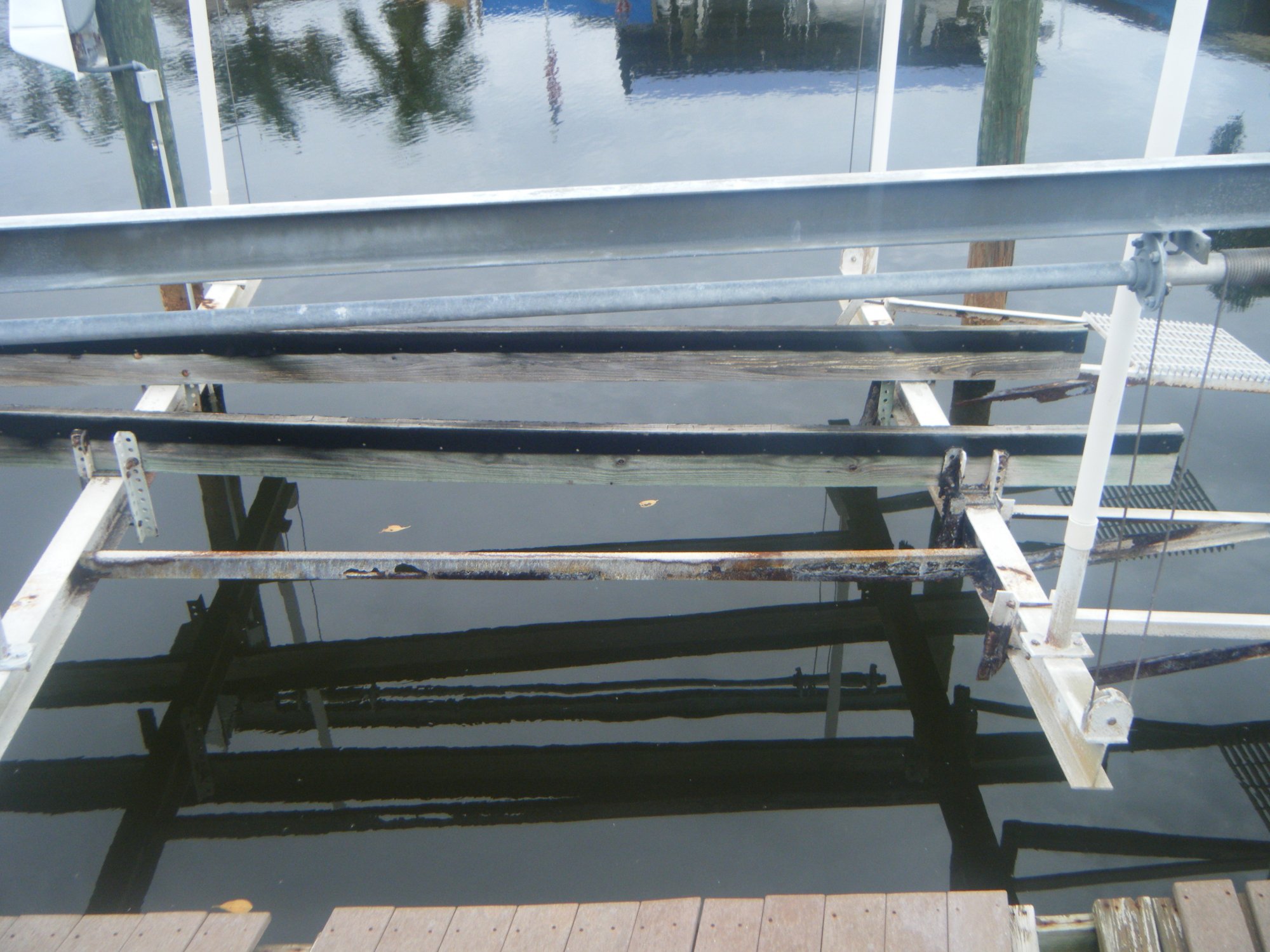

Im changing my plan and looks like I will put the Core Sound 17 on the boat lift once I get the bottom
part of the lift rebuilt later this year. Ive decided I will just use the Davits to lift it for service if needed
in the future. Im sure the boat lift company will figure something out when they replace the cables on the davits aswell. But mainly the davits will be used to lift for service and nothing else. The boat lift has no cover so mast are no problem either.Centerboard will just be cranked up and will slide right on the trunks on the lift. It should make things easy. Im going to have a whole new dock wrap around walkway built to make easy access to it too.
