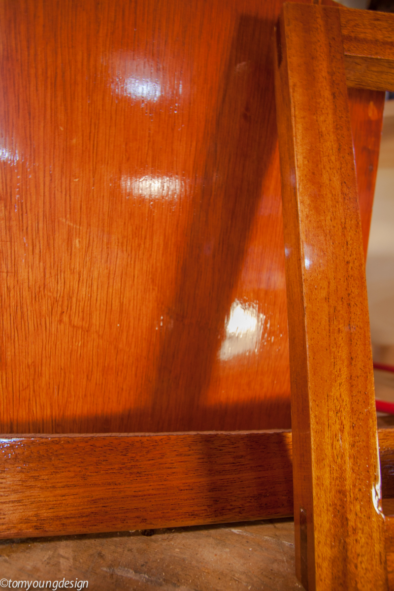

Here's three woods, finished:
Foreground, first piece. This is a piece of original 1961 mahogany reclaimed from my cockpit. Milled into a rail and stile for a door, you can see the mortise and tenon joints holding it together. It only has varnish on it, no filler stain. Beautiful wood, Alden spec'ed Honduran mahogany.
Middle piece, laying horizontal. This is a piece of a renewable tropical hardwood sold as 'mahogany', which I use often for boat projects. Works well with tools, rot resistant, strong. It has only varnish applied. You can see the pores are more prominent than the mahogany, but it's hard to tell the difference on the boat. I pay about $8 a board foot, down the street at a local lumber supply.
The last piece is cheap 1/2" Luan plywood. I added a filler stain before varnishing. For a piece that doesn't show that much, it's a great faux 'mahogany' veneer, when you need one.

do you happen to know what this "renewable tropical mahogany" is called?
is it an actual mahogany wood?
I say the comparison looks very good.
I like seeing real pictures like these posted.
What I get, may be Sapele, which is a Honduran or African tropical hardwood. I think I've heard, "Honduran Mahogany" used, but it's not a true mahogany.
I find the look comparable, too. I have used it for repairs side by side mahogany, and only a wood scientist might notice a difference. Standing alone, it's a great wood for boats.

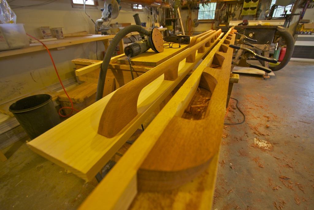

I made new handrails from it a few years ago.

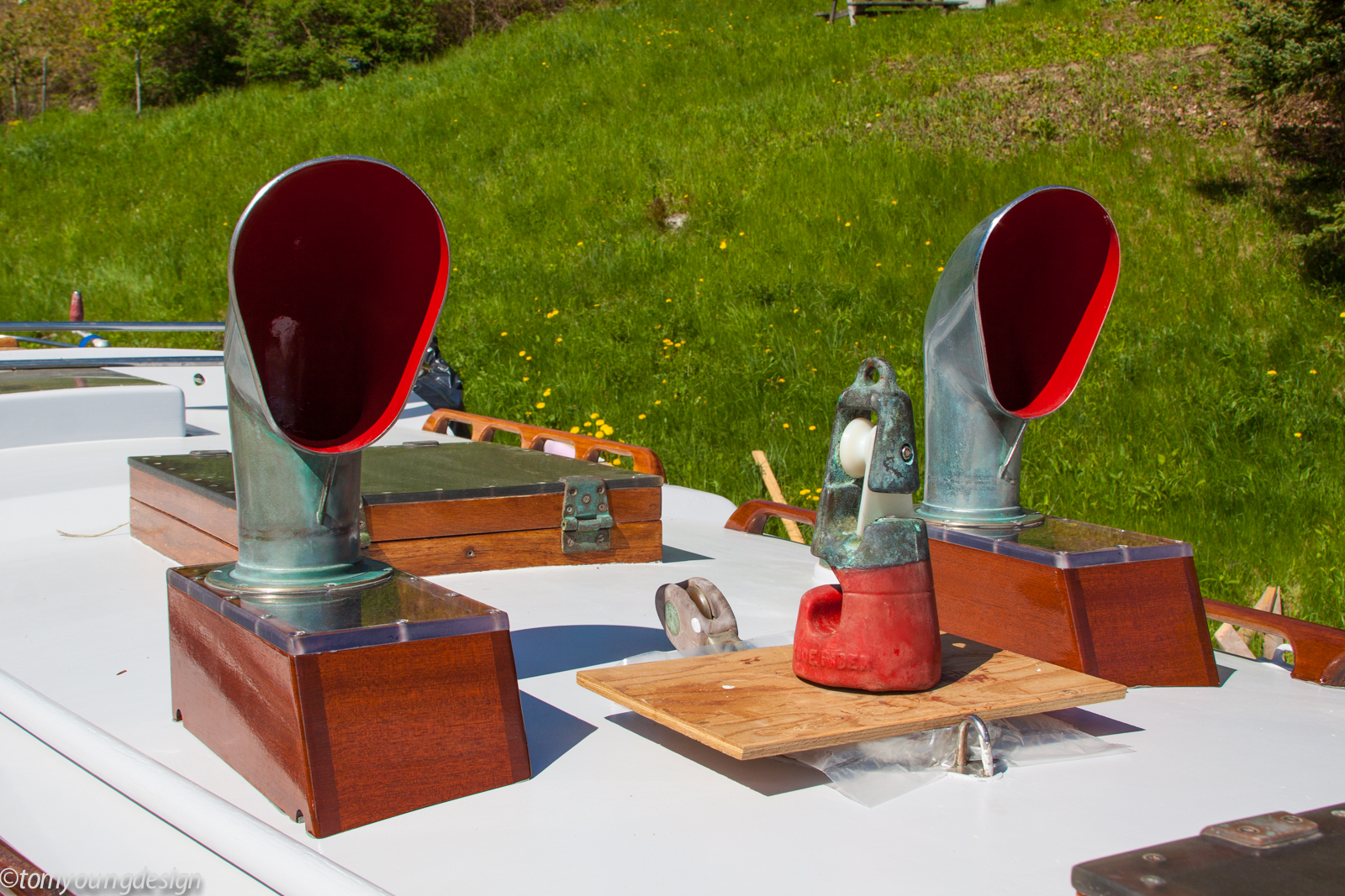

Then, new dorade boxes last year.
